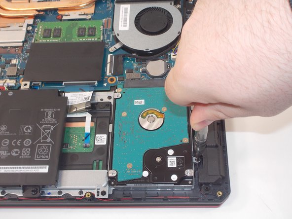

    • Remove the two 6 mm screws holding the hard drive enclosure in place using a Phillips #1 screwdriver.

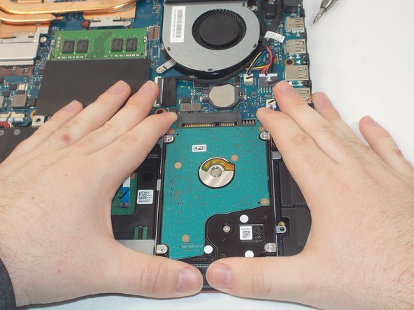

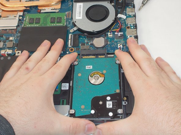

    • Slide the enclosure away from the motherboard slot to unplug the hard drive, then remove the drive and enclosure from the device.

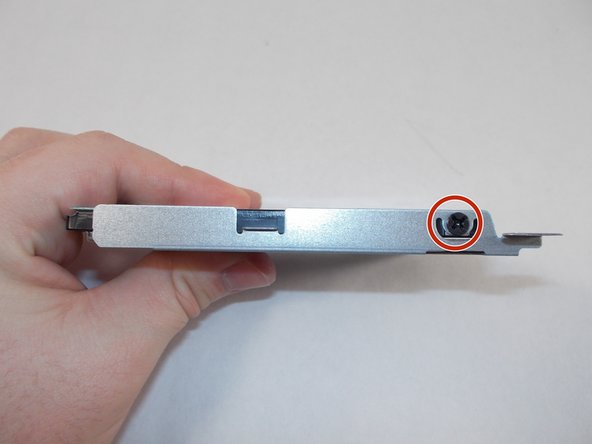

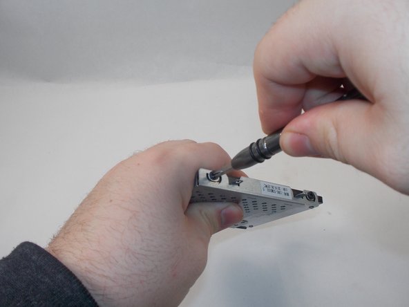

    • Remove the three screws holding the hard drive in the enclosure. The screws in the images are 4 mm Phillips #2, although screw size may vary.

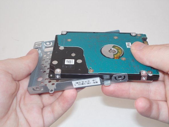

    • The hard drive should move in the enclosure and can be freely removed.
