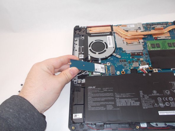

  5. ASUS TUF Gaming FX505DY Display Assembly Replacement, Solid State Drive: crwdns2935265:05crwdnd2935265:01crwdnd2935265:02crwdne2935265:0 ASUS TUF Gaming FX505DY Display Assembly Replacement, Solid State Drive: crwdns2935265:05crwdnd2935265:02crwdnd2935265:02crwdne2935265:0
    • Remove the two 3 mm screws holding the solid state drive and its foil wrap in place using a Phillips #1 screwdriver.
    • The drive will pop up at an angle.
  6. ASUS TUF Gaming FX505DY Display Assembly Replacement: crwdns2935265:06crwdnd2935265:01crwdnd2935265:03crwdne2935265:0 ASUS TUF Gaming FX505DY Display Assembly Replacement: crwdns2935265:06crwdnd2935265:02crwdnd2935265:03crwdne2935265:0 ASUS TUF Gaming FX505DY Display Assembly Replacement: crwdns2935265:06crwdnd2935265:03crwdnd2935265:03crwdne2935265:0
    • Slide the foil wrap off of the drive.
  7. ASUS TUF Gaming FX505DY Display Assembly Replacement: crwdns2935265:07crwdnd2935265:01crwdnd2935265:02crwdne2935265:0 ASUS TUF Gaming FX505DY Display Assembly Replacement: crwdns2935265:07crwdnd2935265:02crwdnd2935265:02crwdne2935265:0
    • Remove the solid state drive by pulling it at an angle from the motherboard.

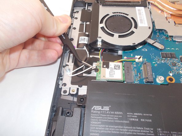

  8. ASUS TUF Gaming FX505DY Display Assembly Replacement, Wi-Fi Card: crwdns2935265:08crwdnd2935265:01crwdnd2935265:01crwdne2935265:0
    • Remove the tape covering the Wi-Fi card.
  9. ASUS TUF Gaming FX505DY Display Assembly Replacement: crwdns2935265:09crwdnd2935265:01crwdnd2935265:03crwdne2935265:0 ASUS TUF Gaming FX505DY Display Assembly Replacement: crwdns2935265:09crwdnd2935265:02crwdnd2935265:03crwdne2935265:0 ASUS TUF Gaming FX505DY Display Assembly Replacement: crwdns2935265:09crwdnd2935265:03crwdnd2935265:03crwdne2935265:0
    • Using ESD-safe tweezers, remove the two coaxial antennas by lifting up on the wires near the connectors.

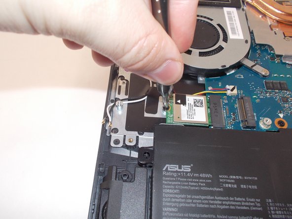

  10. ASUS TUF Gaming FX505DY Display Assembly Replacement: crwdns2935265:010crwdnd2935265:01crwdnd2935265:02crwdne2935265:0 ASUS TUF Gaming FX505DY Display Assembly Replacement: crwdns2935265:010crwdnd2935265:02crwdnd2935265:02crwdne2935265:0
    • Remove the 6 mm screw using a Phillips #1 screwdriver.
  11. ASUS TUF Gaming FX505DY Display Assembly Replacement: crwdns2935265:011crwdnd2935265:01crwdnd2935265:02crwdne2935265:0 ASUS TUF Gaming FX505DY Display Assembly Replacement: crwdns2935265:011crwdnd2935265:02crwdnd2935265:02crwdne2935265:0
    • Remove the Wi-Fi card by pulling it straight away from its slot.
