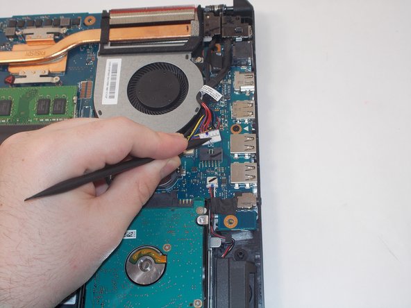

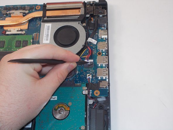

  5. ASUS TUF Gaming FX505DY Charging Port Replacement, Charging Port: crwdns2935265:05crwdnd2935265:01crwdnd2935265:03crwdne2935265:0 ASUS TUF Gaming FX505DY Charging Port Replacement, Charging Port: crwdns2935265:05crwdnd2935265:02crwdnd2935265:03crwdne2935265:0 ASUS TUF Gaming FX505DY Charging Port Replacement, Charging Port: crwdns2935265:05crwdnd2935265:03crwdnd2935265:03crwdne2935265:0
    • Using an ESD-safe spudger, disconnect the charging port connector by pulling the plug away from its port.

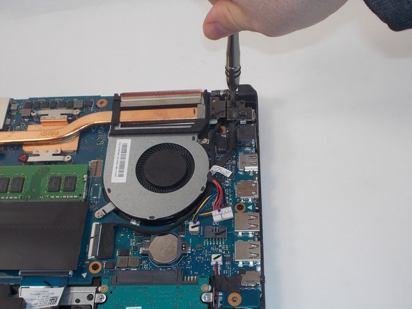

  6. ASUS TUF Gaming FX505DY Charging Port Replacement: crwdns2935265:06crwdnd2935265:01crwdnd2935265:02crwdne2935265:0 ASUS TUF Gaming FX505DY Charging Port Replacement: crwdns2935265:06crwdnd2935265:02crwdnd2935265:02crwdne2935265:0
    • Remove the two 6mm screws holding the screen hinge and charging port in place using a Phillips #1 screwdriver.

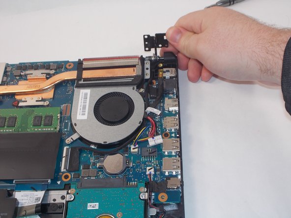

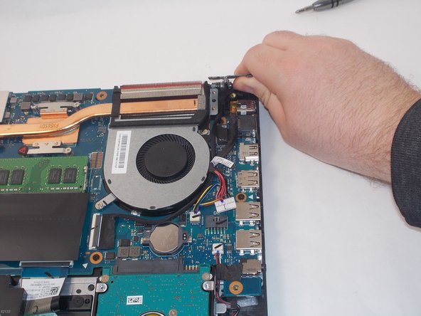

  7. ASUS TUF Gaming FX505DY Charging Port Replacement: crwdns2935265:07crwdnd2935265:01crwdnd2935265:03crwdne2935265:0 ASUS TUF Gaming FX505DY Charging Port Replacement: crwdns2935265:07crwdnd2935265:02crwdnd2935265:03crwdne2935265:0 ASUS TUF Gaming FX505DY Charging Port Replacement: crwdns2935265:07crwdnd2935265:03crwdnd2935265:03crwdne2935265:0
    • Firmly lift the screen hinge out of the way.
    • The hinge supports the weight of the screen, so it is stiff. Use consistent force.
