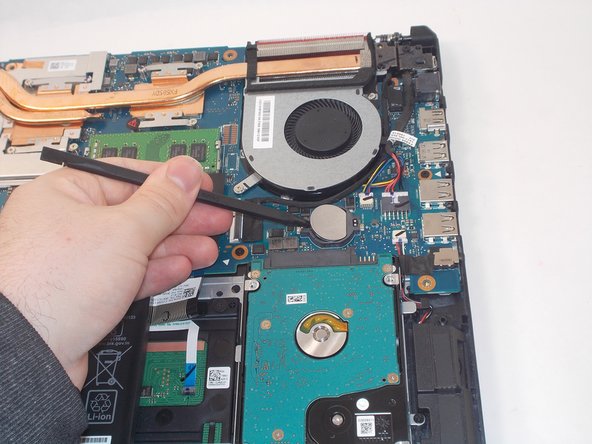

    • Gently insert the narrow end of a spudger beneath the CMOS battery and push in, raising the battery.
  6. ASUS TUF Gaming FX505DY CMOS Battery  Replacement: crwdns2935265:06crwdnd2935265:01crwdnd2935265:01crwdne2935265:0
    • Remove the battery from its socket at an angle.
