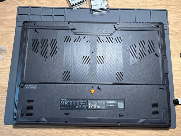

  2. ASUS TUF Gaming A15 (2023) FA507XI RAM Replacement, Unscrew the screws: crwdns2935265:02crwdnd2935265:01crwdnd2935265:01crwdne2935265:0
    • Using a Phillips screwdriver from the Xiaomi Mija set, unscrew all the screws
    • Attention! - The lower right screw is on a latch/lock and cannot be removed from the case
    • Also remember the location of the screws - the two longest ones are central from the top, the short one is installed in the lower left corner. see photo

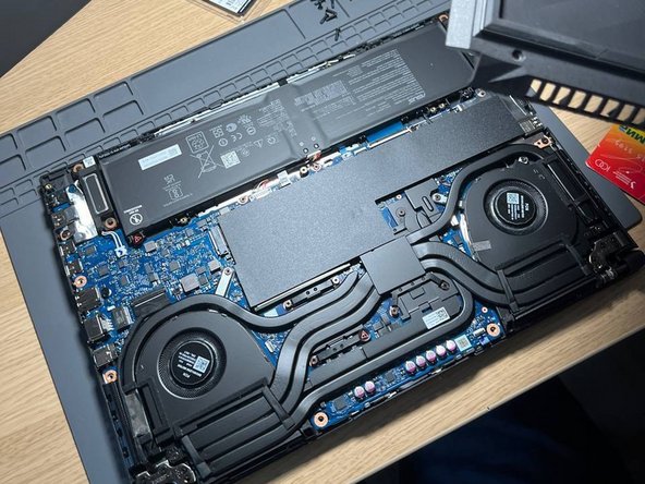

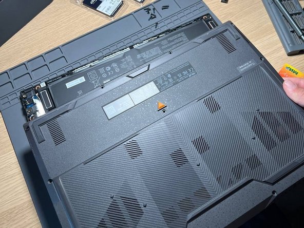

  3. ASUS TUF Gaming A15 (2023) FA507XI RAM Replacement, Removing the back cover: crwdns2935265:03crwdnd2935265:01crwdnd2935265:03crwdne2935265:0 ASUS TUF Gaming A15 (2023) FA507XI RAM Replacement, Removing the back cover: crwdns2935265:03crwdnd2935265:02crwdnd2935265:03crwdne2935265:0 ASUS TUF Gaming A15 (2023) FA507XI RAM Replacement, Removing the back cover: crwdns2935265:03crwdnd2935265:03crwdnd2935265:03crwdne2935265:0
    • Carefully, starting from the lower right corner, we begin to unclip the clips off the back cover and, as a result, we can remove it.
  4. ASUS TUF Gaming A15 (2023) FA507XI RAM Replacement, Removing the battery off the motherboard: crwdns2935265:04crwdnd2935265:01crwdnd2935265:02crwdne2935265:0 ASUS TUF Gaming A15 (2023) FA507XI RAM Replacement, Removing the battery off the motherboard: crwdns2935265:04crwdnd2935265:02crwdnd2935265:02crwdne2935265:0
    • MUST!!!! Turn off the power to the laptop from the built-in battery by slightly prying the chip on both sides using a credit card.

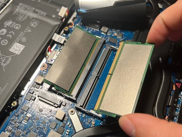

  6. ASUS TUF Gaming A15 (2023) FA507XI RAM Replacement, Removing old RAM: crwdns2935265:06crwdnd2935265:01crwdnd2935265:03crwdne2935265:0 ASUS TUF Gaming A15 (2023) FA507XI RAM Replacement, Removing old RAM: crwdns2935265:06crwdnd2935265:02crwdnd2935265:03crwdne2935265:0 ASUS TUF Gaming A15 (2023) FA507XI RAM Replacement, Removing old RAM: crwdns2935265:06crwdnd2935265:03crwdnd2935265:03crwdne2935265:0
    • Unclip the clips holding the RAM (away from the RAM stick) and remove both sticks of RAM.

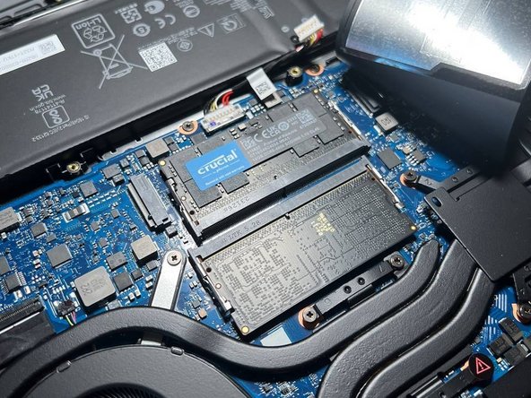

  8. ASUS TUF Gaming A15 (2023) FA507XI RAM Replacement, Installing new RAM: crwdns2935265:08crwdnd2935265:01crwdnd2935265:03crwdne2935265:0 ASUS TUF Gaming A15 (2023) FA507XI RAM Replacement, Installing new RAM: crwdns2935265:08crwdnd2935265:02crwdnd2935265:03crwdne2935265:0 ASUS TUF Gaming A15 (2023) FA507XI RAM Replacement, Installing new RAM: crwdns2935265:08crwdnd2935265:03crwdnd2935265:03crwdne2935265:0
    • Carefully install new RAM into the ports. Snap by pressing both corners of the bar at the same time.

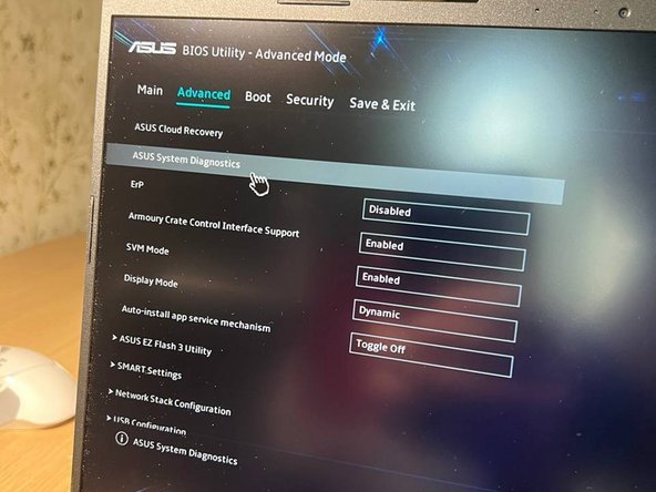

  13. ASUS TUF Gaming A15 (2023) FA507XI RAM Replacement, Entering Diagnostic Mode: crwdns2935265:013crwdnd2935265:01crwdnd2935265:02crwdne2935265:0 ASUS TUF Gaming A15 (2023) FA507XI RAM Replacement, Entering Diagnostic Mode: crwdns2935265:013crwdnd2935265:02crwdnd2935265:02crwdne2935265:0
    • Already in the main BIOS menu, our RAM strips are initialized, press the F7 button or select the advanced settings item in the lower right corner. Then click ASUS System Diagnostics.

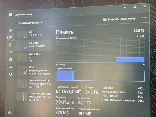

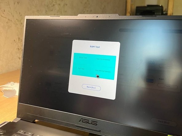

  14. ASUS TUF Gaming A15 (2023) FA507XI RAM Replacement, RAM test: crwdns2935265:014crwdnd2935265:01crwdnd2935265:03crwdne2935265:0 ASUS TUF Gaming A15 (2023) FA507XI RAM Replacement, RAM test: crwdns2935265:014crwdnd2935265:02crwdnd2935265:03crwdne2935265:0 ASUS TUF Gaming A15 (2023) FA507XI RAM Replacement, RAM test: crwdns2935265:014crwdnd2935265:03crwdnd2935265:03crwdne2935265:0
    • Once in the diagnostics menu, select RAM - diagnostics of RAM. Next, select 100% in the drop-down window and wait for the verification to complete. If successful, you will receive a window like this.
  15. ASUS TUF Gaming A15 (2023) FA507XI RAM Replacement, Congratulations!: crwdns2935265:015crwdnd2935265:01crwdnd2935265:02crwdne2935265:0 ASUS TUF Gaming A15 (2023) FA507XI RAM Replacement, Congratulations!: crwdns2935265:015crwdnd2935265:02crwdnd2935265:02crwdne2935265:0
    • Congratulations, you have successfully upgraded the RAM on your laptop! This cake is for you!
