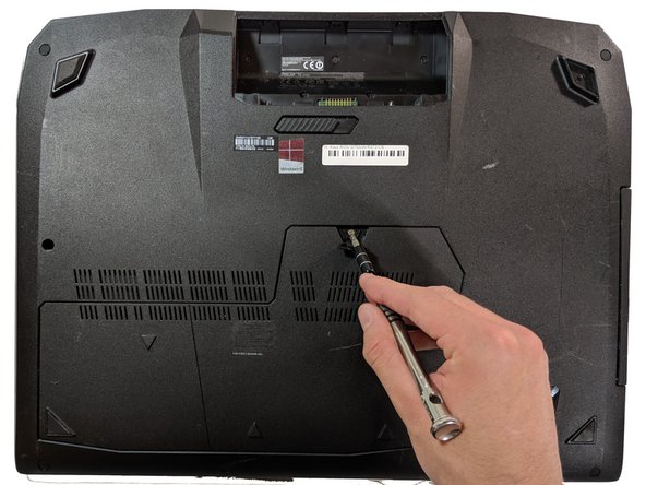

    • Open flap in center and underneath you will find a screw, remove the 5.2mm screw with a Phillips #0 screwdriver.
