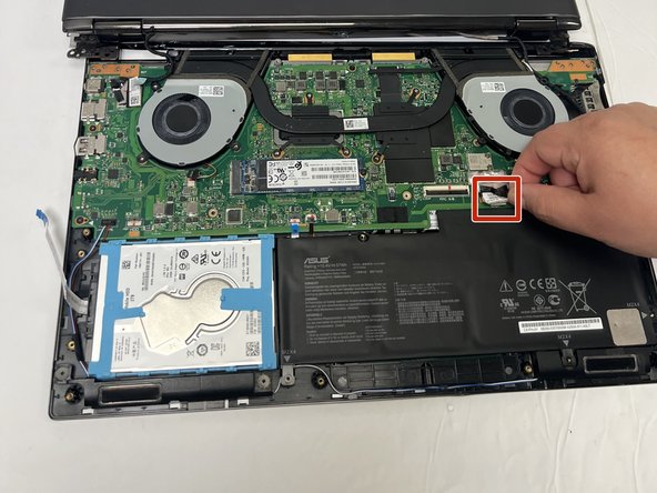

  2. ASUS Q536F Screen Replacement, Display Assembly: crwdns2935265:02crwdnd2935265:01crwdnd2935265:01crwdne2935265:0
    • Remove the six 2 mm screws from the hinges using a Phillips #0 screwdriver.
  3. ASUS Q536F Screen Replacement: crwdns2935265:03crwdnd2935265:01crwdnd2935265:03crwdne2935265:0 ASUS Q536F Screen Replacement: crwdns2935265:03crwdnd2935265:02crwdnd2935265:03crwdne2935265:0 ASUS Q536F Screen Replacement: crwdns2935265:03crwdnd2935265:03crwdnd2935265:03crwdne2935265:0
    • Using your fingers, unplug the two power cables connecting the display to the motherboard.
    • Remove the display assembly from the laptop.

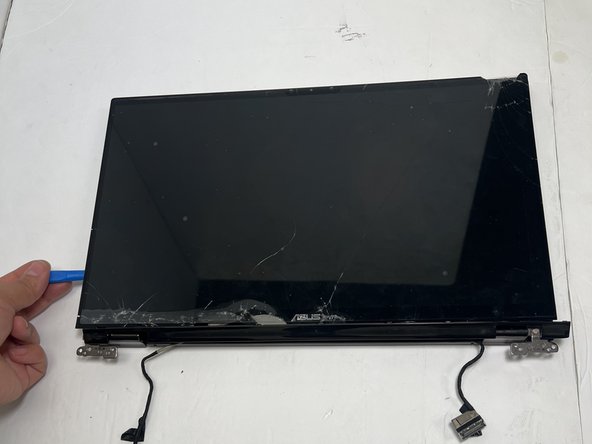

  4. ASUS Q536F Screen Replacement, Screen: crwdns2935265:04crwdnd2935265:01crwdnd2935265:03crwdne2935265:0 ASUS Q536F Screen Replacement, Screen: crwdns2935265:04crwdnd2935265:02crwdnd2935265:03crwdne2935265:0 ASUS Q536F Screen Replacement, Screen: crwdns2935265:04crwdnd2935265:03crwdnd2935265:03crwdne2935265:0
    • Potential for device damage: Beneath the screen border is a sticky adhesive. Take your time and exercise caution when removing to avoid damaging it.
    • Use an iOpener to help loosen the adhesive on the screen.
    • Gently pry the bottom right corner of the screen's border and remove the sticky screen cover.
    • Use the opening tool around the entire display to ensure you cut as much adhesive as possible.

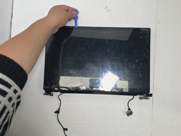

  5. ASUS Q536F Screen Replacement: crwdns2935265:05crwdnd2935265:01crwdnd2935265:01crwdne2935265:0
    • Carefully remove the screen from the rest of the display.
    • The new screen should come with the sticky adhesive.
