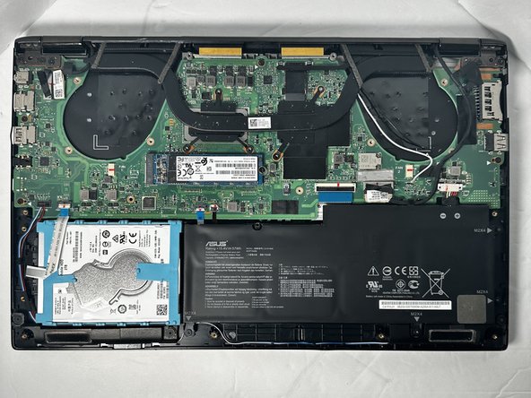

  2. ASUS Q536F Motherboard Replacement, Battery: crwdns2935265:02crwdnd2935265:01crwdnd2935265:02crwdne2935265:0 ASUS Q536F Motherboard Replacement, Battery: crwdns2935265:02crwdnd2935265:02crwdnd2935265:02crwdne2935265:0
    • Remove the four 2 mm screws from the battery using a Phillips #1 screwdriver.
    • Detach the battery cable from the motherboard using a pair of tweezers.
  3. ASUS Q536F Motherboard Replacement: crwdns2935265:03crwdnd2935265:01crwdnd2935265:03crwdne2935265:0 ASUS Q536F Motherboard Replacement: crwdns2935265:03crwdnd2935265:02crwdnd2935265:03crwdne2935265:0 ASUS Q536F Motherboard Replacement: crwdns2935265:03crwdnd2935265:03crwdnd2935265:03crwdne2935265:0
    • Unhinge the fan cable using your fingers or a pair of tweezers.
    • Remove the battery from its slot.
    • There should be no resistance from any cable wiring at this point. If there happens to be resistance, make sure to double check and confirm nothing is being pulled.

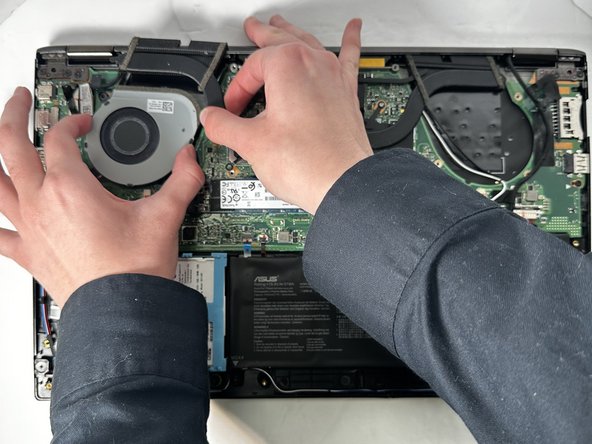

  4. ASUS Q536F Motherboard Replacement, Fan: crwdns2935265:04crwdnd2935265:01crwdnd2935265:02crwdne2935265:0 ASUS Q536F Motherboard Replacement, Fan: crwdns2935265:04crwdnd2935265:02crwdnd2935265:02crwdne2935265:0
    • Use a Phillips #0 screwdriver to remove the six 2 mm fan screws.
    • Use a Phillips #0 screwdriver to remove the five 2 mm heatsink screws.
    • Warped Screw
    • Heatsink shown has warped screw, so unable to remove

  6. ASUS Q536F Motherboard Replacement: crwdns2935265:06crwdnd2935265:01crwdnd2935265:02crwdne2935265:0 ASUS Q536F Motherboard Replacement: crwdns2935265:06crwdnd2935265:02crwdnd2935265:02crwdne2935265:0
    • Disconnect fan cables pulling outwards as shown.
  7. ASUS Q536F Motherboard Replacement: crwdns2935265:07crwdnd2935265:01crwdnd2935265:03crwdne2935265:0 ASUS Q536F Motherboard Replacement: crwdns2935265:07crwdnd2935265:02crwdnd2935265:03crwdne2935265:0 ASUS Q536F Motherboard Replacement: crwdns2935265:07crwdnd2935265:03crwdnd2935265:03crwdne2935265:0
    • Carefully lift heatsink upward using a Ifixit opening tool or Fingers pull fan out from under the heat sink.
    • The fan can be removed without removing the heatsink, although it may be easier to remove.

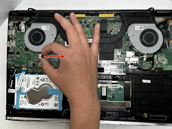

  8. ASUS Q536F Motherboard Replacement, Hard Drive: crwdns2935265:08crwdnd2935265:01crwdnd2935265:02crwdne2935265:0 ASUS Q536F Motherboard Replacement, Hard Drive: crwdns2935265:08crwdnd2935265:02crwdnd2935265:02crwdne2935265:0
    • Disconnect the white ribbon cable from the connection lever using a Jimmy.
  9. ASUS Q536F Motherboard Replacement: crwdns2935265:09crwdnd2935265:01crwdnd2935265:02crwdne2935265:0 ASUS Q536F Motherboard Replacement: crwdns2935265:09crwdnd2935265:02crwdnd2935265:02crwdne2935265:0
    • Using the Jimmy, lift the hard drive out of its slot.
