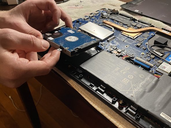

  5. ASUS Q524U Hard Drive Replacement: crwdns2935265:05crwdnd2935265:01crwdnd2935265:01crwdne2935265:0
    • Using the T4 screwdriver, remove the four 1.3 mm screws connecting the hard drive to the motherboard.
    • The hard-drive is located in the bottom left corner of the motherboard.
  6. ASUS Q524U Hard Drive Replacement: crwdns2935265:06crwdnd2935265:01crwdnd2935265:02crwdne2935265:0 ASUS Q524U Hard Drive Replacement: crwdns2935265:06crwdnd2935265:02crwdnd2935265:02crwdne2935265:0
    • Once all the screws are removed from the port, lift the hard drive out of its casing. After, disconnect the hard drive from the motherboard.
