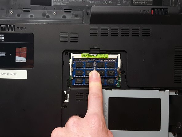

    • The RAM is located in the top of the section you uncovered.
    • Identify the two metal tabs on both sides of the RAM.
    • Gently push both tabs outwards at the same time. The RAM will pop up.
    • Carefully pull the RAM out.
  7. ASUS Q400A-BHI7N03 RAM Replacement: crwdns2935265:07crwdnd2935265:01crwdnd2935265:02crwdne2935265:0 ASUS Q400A-BHI7N03 RAM Replacement: crwdns2935265:07crwdnd2935265:02crwdnd2935265:02crwdne2935265:0
    • To put RAM back in, lineup the RAM with the plastic holder.
    • Slide it into the slot at a 30 degree angle and push down until it clicks into place.
