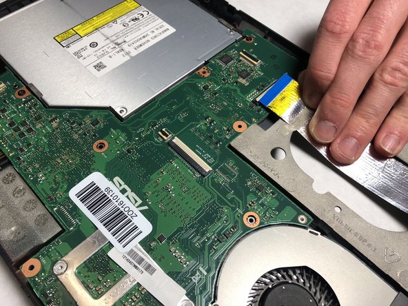

  7. ASUS Q400A-BHI7N03 Power Jack Replacement: crwdns2935265:07crwdnd2935265:01crwdnd2935265:01crwdne2935265:0
    • Release the ZIF (zero insertion force) connector using a plastic spudger.
    • Remove the ribbon cable by hand from the ZIF connector.
    • Do not use too much force when releasing the ZIF connector.
  8. ASUS Q400A-BHI7N03 Power Jack Replacement: crwdns2935265:08crwdnd2935265:01crwdnd2935265:02crwdne2935265:0 ASUS Q400A-BHI7N03 Power Jack Replacement: crwdns2935265:08crwdnd2935265:02crwdnd2935265:02crwdne2935265:0
    • Remove the two remaining ribbon cables as described in Step 7.
