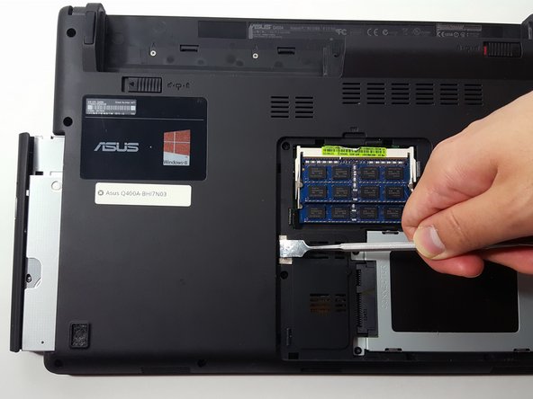

  4. ASUS Q400A-BHI7N03 Optical Drive Replacement, Optical Drive: crwdns2935265:04crwdnd2935265:01crwdnd2935265:01crwdne2935265:0
    • Locate and remove the 8mm PH0 screw near the middle of the laptop.
  5. ASUS Q400A-BHI7N03 Optical Drive Replacement: crwdns2935265:05crwdnd2935265:01crwdnd2935265:02crwdne2935265:0 ASUS Q400A-BHI7N03 Optical Drive Replacement: crwdns2935265:05crwdnd2935265:02crwdnd2935265:02crwdne2935265:0
    • Use a metal opening tool to remove the L-shaped, plastic cover.
    • To avoid breaking the plastic, alternate the sides where you pry.
  6. ASUS Q400A-BHI7N03 Optical Drive Replacement: crwdns2935265:06crwdnd2935265:01crwdnd2935265:02crwdne2935265:0 ASUS Q400A-BHI7N03 Optical Drive Replacement: crwdns2935265:06crwdnd2935265:02crwdnd2935265:02crwdne2935265:0
    • On the left side of the section, there is a metal tab. Using a metal opening tool, push the tab as far as possible to the left.
    • Only push on the metal tab so you do not damage the surrounding plastic.
    • Once the optical drive is sticking out of the left side of the laptop, slide it smoothly out of its slot.
