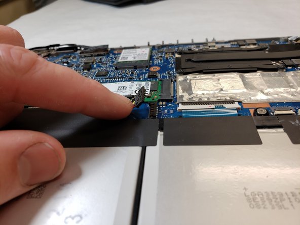

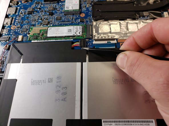

    • Disconnect the battery from the laptop in the upper left side of the battery, using tweezers.

    • Carefully remove the battery using the plastic opening tool.

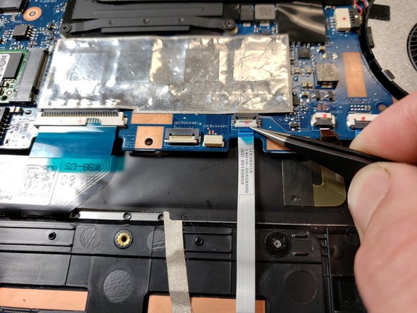

  7. ASUS Q324UA-BHI7T17 Track Pad Replacement: crwdns2935265:07crwdnd2935265:01crwdnd2935265:03crwdne2935265:0 ASUS Q324UA-BHI7T17 Track Pad Replacement: crwdns2935265:07crwdnd2935265:02crwdnd2935265:03crwdne2935265:0 ASUS Q324UA-BHI7T17 Track Pad Replacement: crwdns2935265:07crwdnd2935265:03crwdnd2935265:03crwdne2935265:0
    • Disconnect the trackpad from the motherboard using tweezers.
    • The white tab flips up.

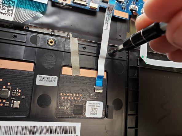

    • Remove the two 5mm screws holding in the trackpad using a Phillips #0 screwdriver.

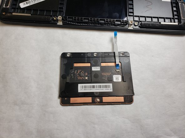

  9. ASUS Q324UA-BHI7T17 Track Pad Replacement: crwdns2935265:09crwdnd2935265:01crwdnd2935265:02crwdne2935265:0 ASUS Q324UA-BHI7T17 Track Pad Replacement: crwdns2935265:09crwdnd2935265:02crwdnd2935265:02crwdne2935265:0

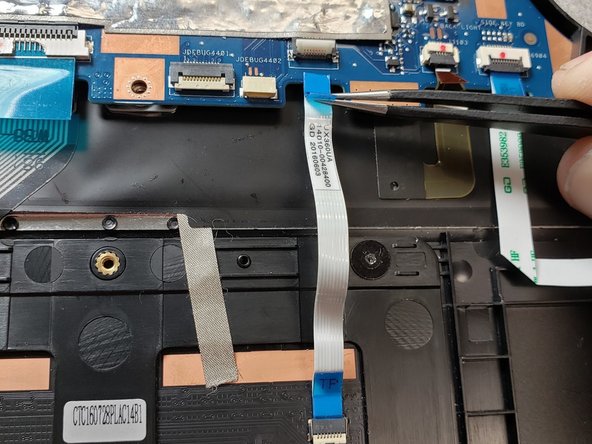

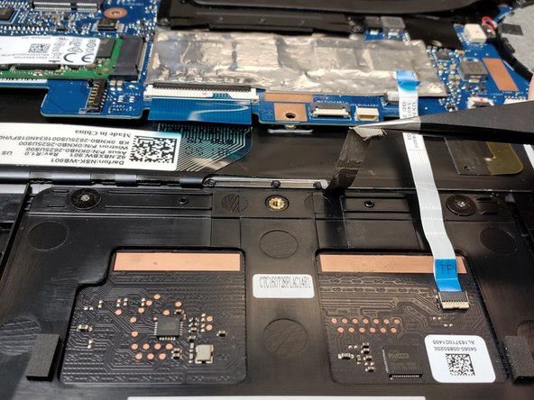

    • Remove adhesive tape tethering the trackpad to the motherboard with tweezers.
  10. ASUS Q324UA-BHI7T17 Track Pad Replacement: crwdns2935265:010crwdnd2935265:01crwdnd2935265:03crwdne2935265:0 ASUS Q324UA-BHI7T17 Track Pad Replacement: crwdns2935265:010crwdnd2935265:02crwdnd2935265:03crwdne2935265:0 ASUS Q324UA-BHI7T17 Track Pad Replacement: crwdns2935265:010crwdnd2935265:03crwdnd2935265:03crwdne2935265:0

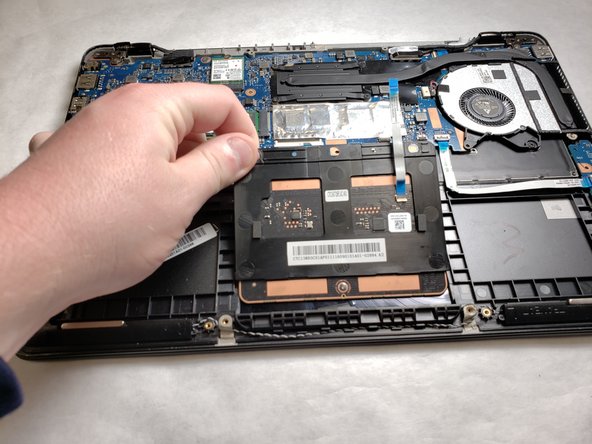

    • Carefully remove the trackpad using the plastic opening tool.
    • Lift up and side track toward the back of the computer to remove.
