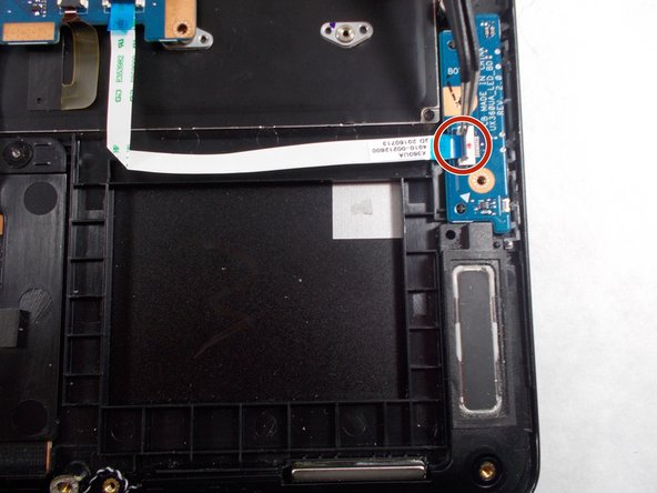

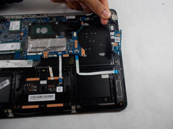

  6. ASUS Q324UA-BHI7T17 Power & Volume Button PCB Board Replacement, Power & Volume Button PCB Board: crwdns2935265:06crwdnd2935265:01crwdnd2935265:01crwdne2935265:0
    • Remove the screw holding the Power chip in place and remove it using a Phillips head #0 screw driver.
    • Screw length is 0.5 cm in length and 0.5 cm in diameter
  7. ASUS Q324UA-BHI7T17 Power & Volume Button PCB Board Replacement: crwdns2935265:07crwdnd2935265:01crwdnd2935265:03crwdne2935265:0 ASUS Q324UA-BHI7T17 Power & Volume Button PCB Board Replacement: crwdns2935265:07crwdnd2935265:02crwdnd2935265:03crwdne2935265:0 ASUS Q324UA-BHI7T17 Power & Volume Button PCB Board Replacement: crwdns2935265:07crwdnd2935265:03crwdnd2935265:03crwdne2935265:0
    • Locate the ribbon connector connecting the power chip to the mother board.
    • Simply lift up the black component and the ribbon connector should be released, then the power chip should pop out easily.
    • Discard of the old power chip properly.
