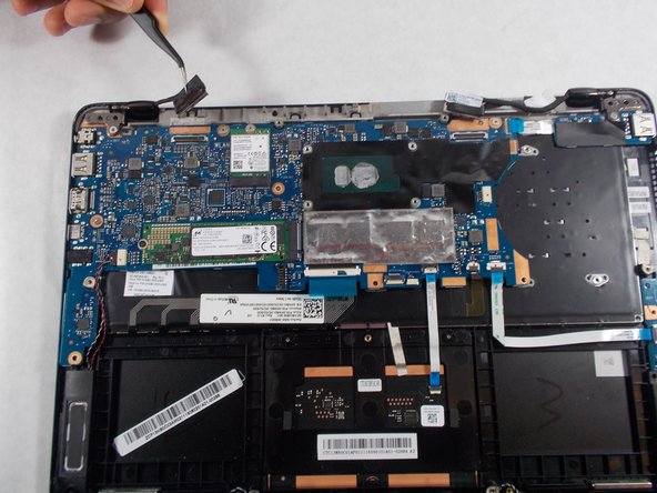

    • Locate the two connectors that are located near the top of the motherboard.
    • Simply lift the two connectors up and they should pop out easily.

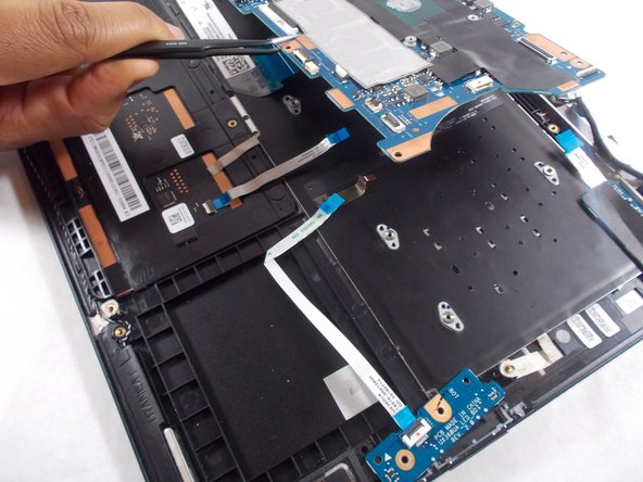

    • Locate all 5 ribbon cables that are connected to the motherboard.
    • Using tweezers lift the black component up therefore allowing the ribbon cable to be released and taken out.

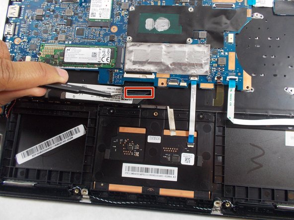

    • Locate the single sliding connector that is attached to the motherboard.
    • Using tweezers slightly remove the sliding connector from the motherboard.

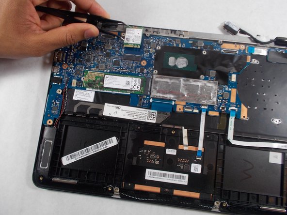

  12. ASUS Q324UA-BHI7T17 Motherboard Replacement: crwdns2935265:012crwdnd2935265:01crwdnd2935265:03crwdne2935265:0 ASUS Q324UA-BHI7T17 Motherboard Replacement: crwdns2935265:012crwdnd2935265:02crwdnd2935265:03crwdne2935265:0 ASUS Q324UA-BHI7T17 Motherboard Replacement: crwdns2935265:012crwdnd2935265:03crwdnd2935265:03crwdne2935265:0

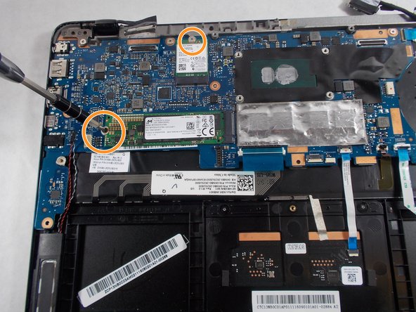

    • There are two chips that are attached to the motherboard. One is a square wifi card and one is a rectangular m.2 ssd, locate them on the motherboard.
    • Remove the two screws holding the chips in place on the mother board.
    • The screw for the rectangle chip is 0.5cm in length and 0.5cm in head diameter. While the square chip screw has a 0.3 cm length and 0.5 cm head diameter.
    • Both chips now can be removed by simply sliding them out of their connectors.

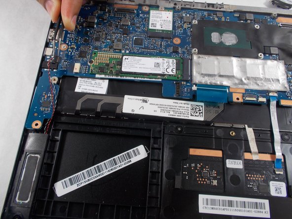

  13. ASUS Q324UA-BHI7T17 Motherboard Replacement: crwdns2935265:013crwdnd2935265:01crwdnd2935265:02crwdne2935265:0 ASUS Q324UA-BHI7T17 Motherboard Replacement: crwdns2935265:013crwdnd2935265:02crwdnd2935265:02crwdne2935265:0

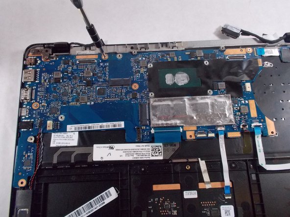

    • Locate the 3 screws near the top of the motherboard holding the motherboard in place.
    • Using a Phillips head #0 screw driver remove each screw driver.
    • The screw all the way to the right is 0.5cm in length and 0.4cm in head diameter. The screw all the way to the left is 0.6 cm in length and 0.4cm in head diameter. The screw in the middle is 0.3cm in length and 0.5 cm in head diameter.
  14. ASUS Q324UA-BHI7T17 Motherboard Replacement: crwdns2935265:014crwdnd2935265:01crwdnd2935265:03crwdne2935265:0 ASUS Q324UA-BHI7T17 Motherboard Replacement: crwdns2935265:014crwdnd2935265:02crwdnd2935265:03crwdne2935265:0 ASUS Q324UA-BHI7T17 Motherboard Replacement: crwdns2935265:014crwdnd2935265:03crwdnd2935265:03crwdne2935265:0

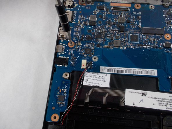

    • Locate the final screw that holds the motherboard in place, on the left side of the motherboard near the middle.
    • Using a Phillips head #0 screwdriver remove the screw. The motherboard should easily pop out and from there properly dispose of the mother board.
    • The screw is 0.3cm in length and 0.5 cm in head diameter.
