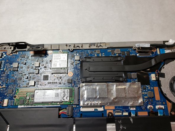

  2. ASUS Q324UA-BHI7T17 Display Assembly Replacement: crwdns2935265:02crwdnd2935265:01crwdnd2935265:01crwdne2935265:0
    • Remove the back plate to access internal components.
  3. ASUS Q324UA-BHI7T17 Display Assembly Replacement: crwdns2935265:03crwdnd2935265:01crwdnd2935265:02crwdne2935265:0 ASUS Q324UA-BHI7T17 Display Assembly Replacement: crwdns2935265:03crwdnd2935265:02crwdnd2935265:02crwdne2935265:0
    • Use a pair of tweezers to disconnect the two black rectangle connections.

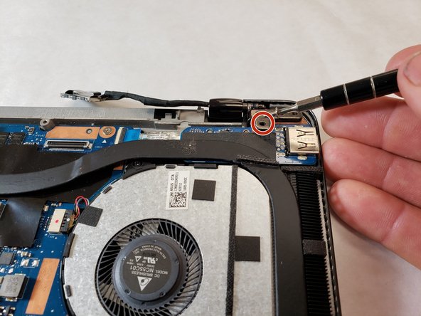

  4. ASUS Q324UA-BHI7T17 Display Assembly Replacement: crwdns2935265:04crwdnd2935265:01crwdnd2935265:02crwdne2935265:0 ASUS Q324UA-BHI7T17 Display Assembly Replacement: crwdns2935265:04crwdnd2935265:02crwdnd2935265:02crwdne2935265:0
    • Remove two 6 mm screws using a Phillips #0 Screwdriver.

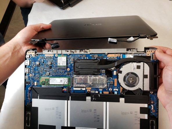

  5. ASUS Q324UA-BHI7T17 Display Assembly Replacement: crwdns2935265:05crwdnd2935265:01crwdnd2935265:02crwdne2935265:0 ASUS Q324UA-BHI7T17 Display Assembly Replacement: crwdns2935265:05crwdnd2935265:02crwdnd2935265:02crwdne2935265:0
    • Everything should be disconnected. Separate the display from the laptop.

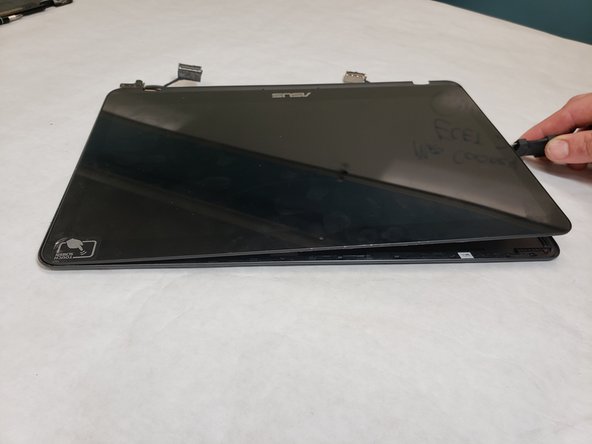

  6. ASUS Q324UA-BHI7T17 Display Assembly Replacement: crwdns2935265:06crwdnd2935265:01crwdnd2935265:03crwdne2935265:0 ASUS Q324UA-BHI7T17 Display Assembly Replacement: crwdns2935265:06crwdnd2935265:02crwdnd2935265:03crwdne2935265:0 ASUS Q324UA-BHI7T17 Display Assembly Replacement: crwdns2935265:06crwdnd2935265:03crwdnd2935265:03crwdne2935265:0
    • Wedge the Jimmy between screen and plastic cover and pry apart.

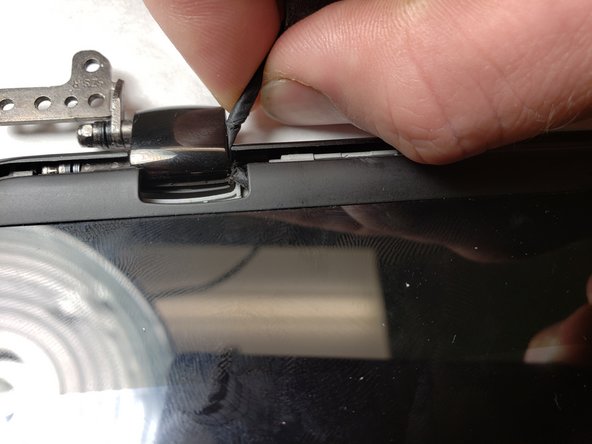

  7. ASUS Q324UA-BHI7T17 Display Assembly Replacement: crwdns2935265:07crwdnd2935265:01crwdnd2935265:02crwdne2935265:0 ASUS Q324UA-BHI7T17 Display Assembly Replacement: crwdns2935265:07crwdnd2935265:02crwdnd2935265:02crwdne2935265:0
    • Dislodge the wires connected to screen from between hinge and plastic cover.
    • Pulling the wires out will require substantial force.
  8. ASUS Q324UA-BHI7T17 Display Assembly Replacement: crwdns2935265:08crwdnd2935265:01crwdnd2935265:01crwdne2935265:0
    • Remove the display from the device.
