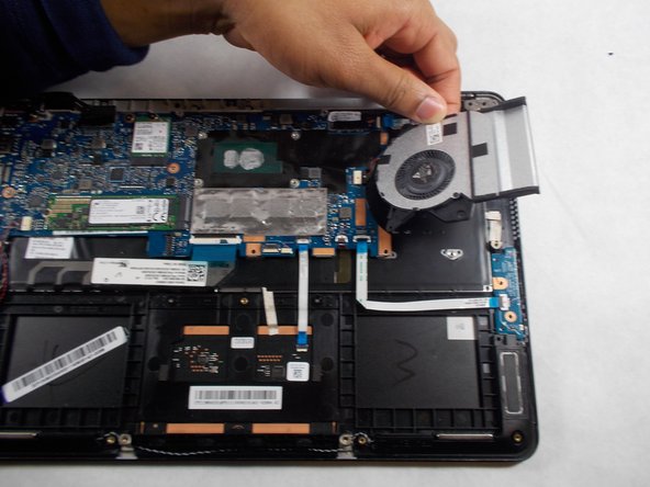

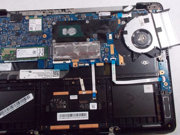

    • Using a Phillips #0 screwdriver remove the six screws holding the CPU Fan and Heatsink in place.
    • All six screws are 0.4 cm in length and have a 0.5 cm head diameter.
  7. ASUS Q324UA-BHI7T17 CPU Fan Replacement: crwdns2935265:07crwdnd2935265:01crwdnd2935265:02crwdne2935265:0 ASUS Q324UA-BHI7T17 CPU Fan Replacement: crwdns2935265:07crwdnd2935265:02crwdnd2935265:02crwdne2935265:0
    • Next, carefully remove the sliding connector that connect the CPU Fan and the laptop together using the tweezers.
  8. ASUS Q324UA-BHI7T17 CPU Fan Replacement: crwdns2935265:08crwdnd2935265:01crwdnd2935265:01crwdne2935265:0
    • Remove the CPU Fan and Heatsink by simply lifting upwards.
