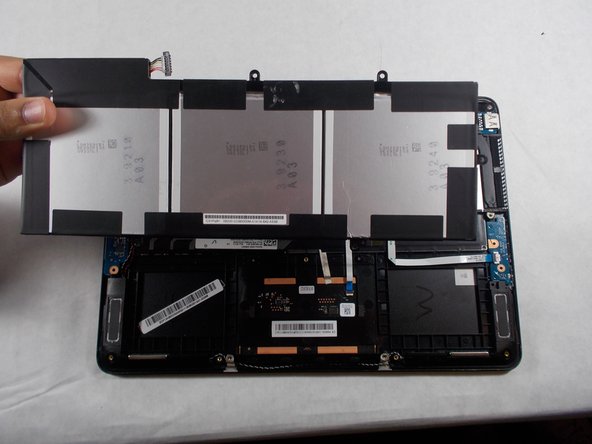

    • Remove all 10 Phillips screws on the backplate.
    • All 10 screws are 0.55 inches and 20 mm in diameter.
  2. ASUS Q324UA-BHI7T17 Battery Replacement: crwdns2935265:02crwdnd2935265:01crwdnd2935265:02crwdne2935265:0 ASUS Q324UA-BHI7T17 Battery Replacement: crwdns2935265:02crwdnd2935265:02crwdnd2935265:02crwdne2935265:0
    • Carefully remove the backplate using the plastic opening tool.
  3. ASUS Q324UA-BHI7T17 Battery Replacement: crwdns2935265:03crwdnd2935265:01crwdnd2935265:01crwdne2935265:0
    • Locate the battery near the bottom.
  4. ASUS Q324UA-BHI7T17 Battery Replacement: crwdns2935265:04crwdnd2935265:01crwdnd2935265:01crwdne2935265:0
    • Next, lift up the battery connector from the laptop in the upper left side of the battery, using tweezers or spudger.
    • Make sure to complete this step with caution, because if the battery is not unplugged, the motherboard may shock you.
  5. ASUS Q324UA-BHI7T17 Battery Replacement: crwdns2935265:05crwdnd2935265:01crwdnd2935265:02crwdne2935265:0 ASUS Q324UA-BHI7T17 Battery Replacement: crwdns2935265:05crwdnd2935265:02crwdnd2935265:02crwdne2935265:0
    • Remove the six screws holding in the battery with a Phillips #0 screwdriver.
    • Once battery is lifted out and removed, proper dispose of the old battery.
    • Each screw is 0.5 cm in length and 0.5 cm in diameter.

The screws in this laptop are *not* all the same length. Unfortunately, I only kept track of some of them as I didn’t notice that they weren’t all the same until I had most of them out. I know that two of the longer screws go in the back between the back feet, but I’m not 100% sure of the others.

I removed the cover successfully (including noting where the long and short screws are located) but cannot get the #0 Phillips screwdriver to fit into those tiny cross shaped slots in the screws holding the battery in. It seems to be too big or the wrong shape, and I am really concerned about stripping the heads by tying to force it too much. Maybe a small regular flat head that will fit into the grooves?
