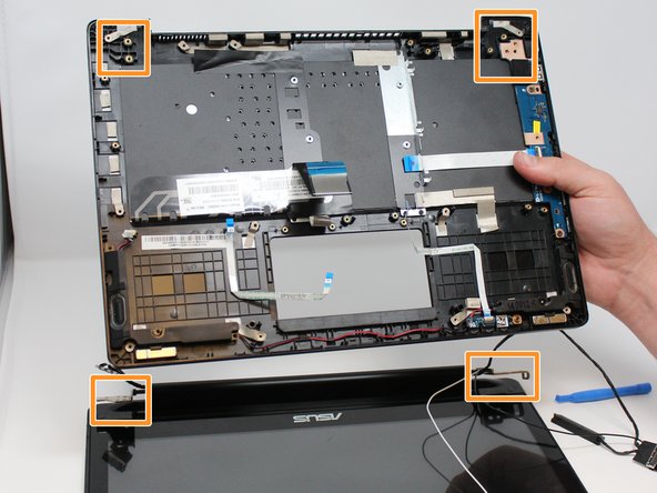

  20. ASUS Q302L Keyboard Replacement, Keyboard: crwdns2935265:020crwdnd2935265:01crwdnd2935265:03crwdne2935265:0 ASUS Q302L Keyboard Replacement, Keyboard: crwdns2935265:020crwdnd2935265:02crwdnd2935265:03crwdne2935265:0 ASUS Q302L Keyboard Replacement, Keyboard: crwdns2935265:020crwdnd2935265:03crwdnd2935265:03crwdne2935265:0
    • Remove the three 4 mm screws using a Phillips #0 screwdriver from the right side hinge.
    • Removal of the right hinge will allow you to remove the display from the keyboard.

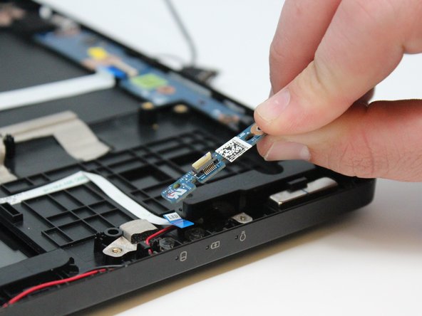

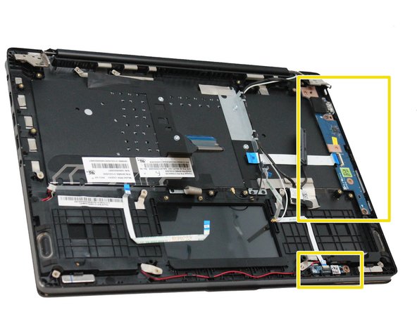

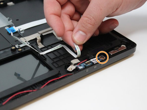

  21. ASUS Q302L Keyboard Replacement: crwdns2935265:021crwdnd2935265:01crwdnd2935265:03crwdne2935265:0 ASUS Q302L Keyboard Replacement: crwdns2935265:021crwdnd2935265:02crwdnd2935265:03crwdne2935265:0 ASUS Q302L Keyboard Replacement: crwdns2935265:021crwdnd2935265:03crwdnd2935265:03crwdne2935265:0
    • Carefully, remove the ribbon connector from the power display circuit board using the iFixit opening tool.
    • Use a Phillips #0 screwdriver to remove the one 4 mm screw on the circuit board.
    • Remove the power display circuit board.

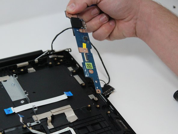

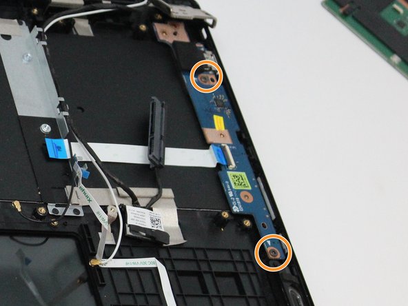

  22. ASUS Q302L Keyboard Replacement: crwdns2935265:022crwdnd2935265:01crwdnd2935265:03crwdne2935265:0 ASUS Q302L Keyboard Replacement: crwdns2935265:022crwdnd2935265:02crwdnd2935265:03crwdne2935265:0 ASUS Q302L Keyboard Replacement: crwdns2935265:022crwdnd2935265:03crwdnd2935265:03crwdne2935265:0
    • Remove the ribbon connector from the power button circuit board using the iFixit opening tool.
    • Use the Philips #0 screwdriver to remove the two 4 mm screws on the circuit board.
    • Remove the circuit board.
