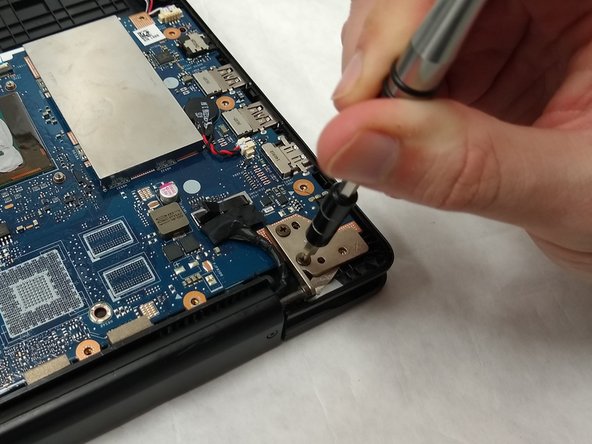

    • Use a Phillips #00 screw driver to remove the five 10mm screws at the hinges.
  8. ASUS Q302L Display Replacement: crwdns2935265:08crwdnd2935265:01crwdnd2935265:03crwdne2935265:0 ASUS Q302L Display Replacement: crwdns2935265:08crwdnd2935265:02crwdnd2935265:03crwdne2935265:0 ASUS Q302L Display Replacement: crwdns2935265:08crwdnd2935265:03crwdnd2935265:03crwdne2935265:0

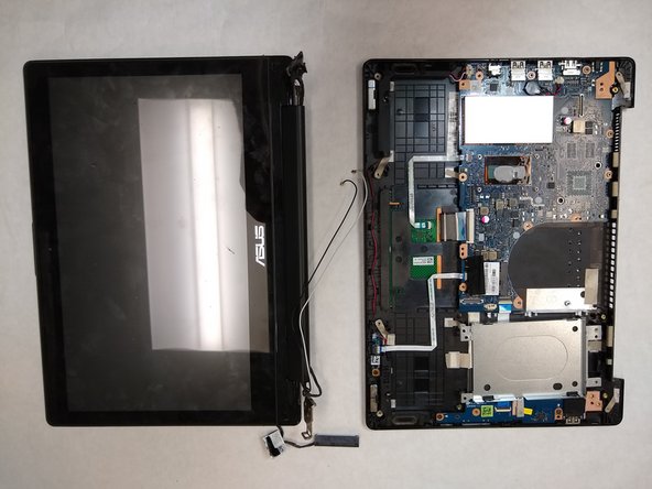

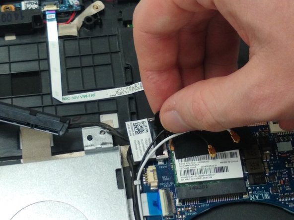

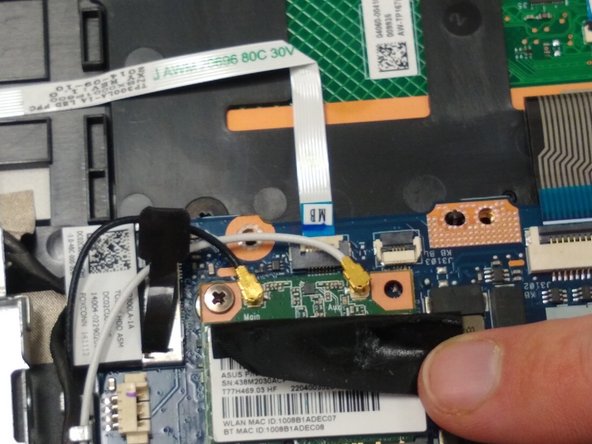

    • Peel back the tape and remove the two connectors.
  9. ASUS Q302L Display Replacement: crwdns2935265:09crwdnd2935265:01crwdnd2935265:02crwdne2935265:0 ASUS Q302L Display Replacement: crwdns2935265:09crwdnd2935265:02crwdnd2935265:02crwdne2935265:0

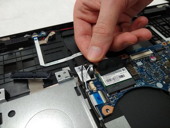

    • Pull up on the black tab to remove the connector that connects to the motherboard.
    • Unplug the hard drive cable from the hard drive.
    • Carefully remove the cables from the track that they run through.
  10. ASUS Q302L Display Replacement: crwdns2935265:010crwdnd2935265:01crwdnd2935265:02crwdne2935265:0 ASUS Q302L Display Replacement: crwdns2935265:010crwdnd2935265:02crwdnd2935265:02crwdne2935265:0
    • Carefully remove the display from the rest of the laptop.
