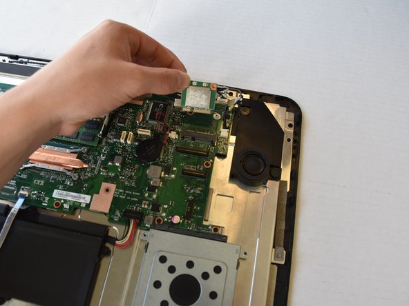

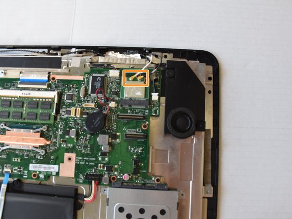

  4. ASUS Portable AiO PT2001 Wireless Card Replacement, Wireless Card: crwdns2935265:04crwdnd2935265:01crwdnd2935265:01crwdne2935265:0
    • The wireless card is on the corner of the motherboard next to the speaker. Remove the black tape to reveal the wireless card.
  5. ASUS Portable AiO PT2001 Wireless Card Replacement: crwdns2935265:05crwdnd2935265:01crwdnd2935265:02crwdne2935265:0 ASUS Portable AiO PT2001 Wireless Card Replacement: crwdns2935265:05crwdnd2935265:02crwdnd2935265:02crwdne2935265:0
    • Remove the 3.5 mm Phillips #1 screw from the wireless card.
    • Remove the connectors by pulling straight up on their ends.
  6. ASUS Portable AiO PT2001 Wireless Card Replacement: crwdns2935265:06crwdnd2935265:01crwdnd2935265:02crwdne2935265:0 ASUS Portable AiO PT2001 Wireless Card Replacement: crwdns2935265:06crwdnd2935265:02crwdnd2935265:02crwdne2935265:0
    • Remove the wireless card from the casing by lifting up then pulling out.
    • The wireless card is fragile. Be careful when pulling it out of the casing.
