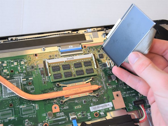

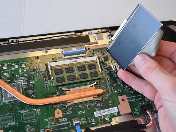

  4. ASUS Portable AiO PT2001 Motherboard Replacement, RAM: crwdns2935265:04crwdnd2935265:01crwdnd2935265:02crwdne2935265:0 ASUS Portable AiO PT2001 Motherboard Replacement, RAM: crwdns2935265:04crwdnd2935265:02crwdnd2935265:02crwdne2935265:0
    • Peel off the tape attaching the metal enclosure to the heat sink.
    • Lift the metal enclosure off of the motherboard.
  5. ASUS Portable AiO PT2001 Motherboard Replacement: crwdns2935265:05crwdnd2935265:01crwdnd2935265:03crwdne2935265:0 ASUS Portable AiO PT2001 Motherboard Replacement: crwdns2935265:05crwdnd2935265:02crwdnd2935265:03crwdne2935265:0 ASUS Portable AiO PT2001 Motherboard Replacement: crwdns2935265:05crwdnd2935265:03crwdnd2935265:03crwdne2935265:0
    • Pull the jaws of the white plastic frame apart. This will pop the front of the RAM up.
    • Gently lift the front edge of the RAM.
    • Pull the RAM out and up.

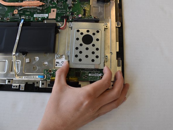

  13. ASUS Portable AiO PT2001 Motherboard Replacement: crwdns2935265:013crwdnd2935265:01crwdnd2935265:02crwdne2935265:0 ASUS Portable AiO PT2001 Motherboard Replacement: crwdns2935265:013crwdnd2935265:02crwdnd2935265:02crwdne2935265:0
    • Use a Phillips #1 screwdriver to remove the four-5mm screws that hold the hard drive enclosure to the PC.
    • Pull the hard drive away from the motherboard and set it aside.
