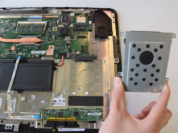

  4. ASUS Portable AiO PT2001 Hard Drive Replacement, Hard Drive: crwdns2935265:04crwdnd2935265:01crwdnd2935265:01crwdne2935265:0
    • Remove the four 5.0 mm Phillips #1 screws on the outer casing of the hard drive.
  5. ASUS Portable AiO PT2001 Hard Drive Replacement: crwdns2935265:05crwdnd2935265:01crwdnd2935265:02crwdne2935265:0 ASUS Portable AiO PT2001 Hard Drive Replacement: crwdns2935265:05crwdnd2935265:02crwdnd2935265:02crwdne2935265:0
    • Gently pull the hard drive away to disconnect it from the motherboard.
  6. ASUS Portable AiO PT2001 Hard Drive Replacement: crwdns2935265:06crwdnd2935265:01crwdnd2935265:01crwdne2935265:0
    • Remove the four 3.5 mm Phillips #1 screws on the edges of the outer casing, two on each side.
  7. ASUS Portable AiO PT2001 Hard Drive Replacement: crwdns2935265:07crwdnd2935265:01crwdnd2935265:01crwdne2935265:0
    • Separate the hard drive from the casing.
