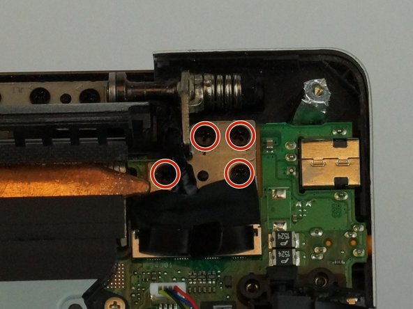

  5. ASUS N550JK-DS71T Laptop Screen Replacement, Screen: crwdns2935265:05crwdnd2935265:01crwdnd2935265:02crwdne2935265:0 ASUS N550JK-DS71T Laptop Screen Replacement, Screen: crwdns2935265:05crwdnd2935265:02crwdnd2935265:02crwdne2935265:0
    • Remove the eight black 4mm Phillips #1 screws holding display to laptop base.

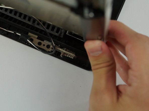

    • Open then close the laptop to separate the metal hinges between display and base.
    • Open the laptop again then gently remove the base of the laptop from the display.

    • After removing the display from the board, slide the grey hinge cap to remove.

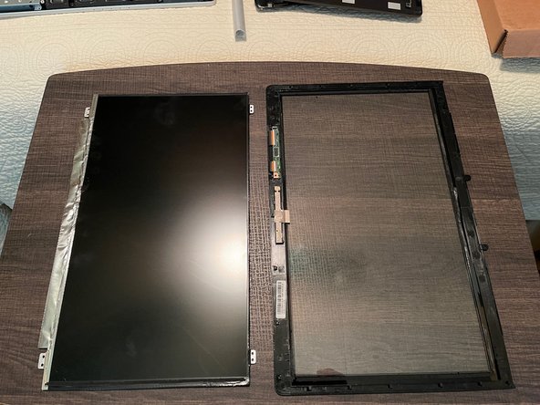

  12. ASUS N550JK-DS71T Laptop Screen Replacement, Remove screen from glass bezel: crwdns2935265:012crwdnd2935265:01crwdnd2935265:02crwdne2935265:0 ASUS N550JK-DS71T Laptop Screen Replacement, Remove screen from glass bezel: crwdns2935265:012crwdnd2935265:02crwdnd2935265:02crwdne2935265:0
    • Using a spudger or soft pry tool, work your way around the edge of the screen to separate the screen from the bezel adhesive strips. Take your time, and be careful not to break the bezel.
  13. ASUS N550JK-DS71T Laptop Screen Replacement, Clean Glass Bezel: crwdns2935265:013crwdnd2935265:01crwdnd2935265:01crwdne2935265:0
    • Before installing new screen, ensure that the adhesive strips are laying flat around the edges, and clean the surface of the screen of debris from prying the old screen off. These will show up on the new screen if you sandwich them in between the glass and the screen.
