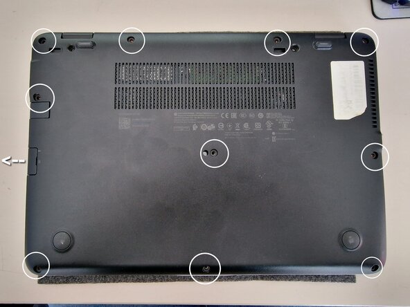

    • Remove the 11 screws securing the back panel.

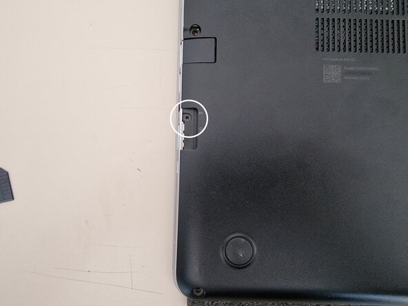

    • Don't forget the screw hidden inside the SD card slot — this one is easy to miss.
    • Screw lengths may vary. Keep track of their original positions using a magnetic project mat or labeled containers.

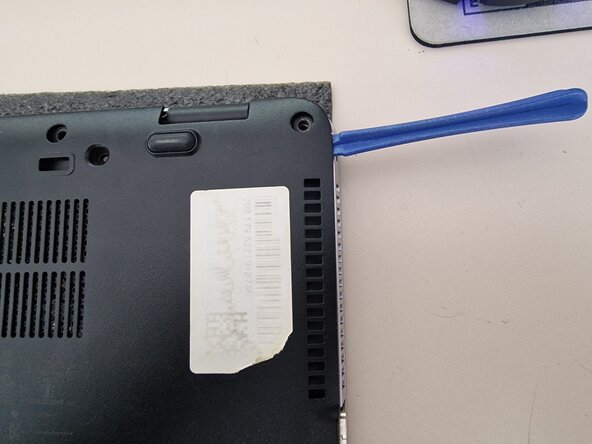

  2. ASUS Laptop Battery, SSD, and RAM Removal, Pry Open the Back Cover: crwdns2935265:02crwdnd2935265:01crwdnd2935265:02crwdne2935265:0 ASUS Laptop Battery, SSD, and RAM Removal, Pry Open the Back Cover: crwdns2935265:02crwdnd2935265:02crwdnd2935265:02crwdne2935265:0
    iFixit Opening Tool
    $1.99

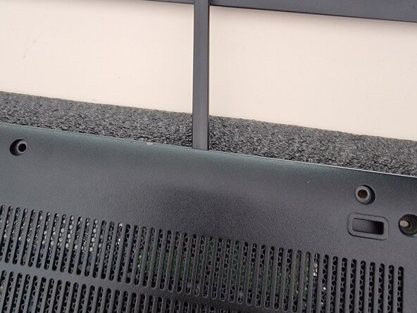

    • Use a plastic opening tool to gently separate the back cover from the chassis.
    • Start on one side (left or right) and carefully work your way around the entire perimeter.
    • Take your time to avoid damaging clips or scratching the surface.
    • If the cover feels stuck, double-check that all screws are fully removed — especially the one in the SD slot.

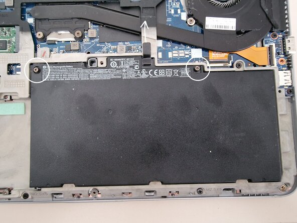

  3. ASUS Laptop Battery, SSD, and RAM Removal, Remove the Battery: crwdns2935265:03crwdnd2935265:01crwdnd2935265:01crwdne2935265:0
    • Locate the two screws securing the battery.
    • These screws won’t come out completely — just loosen them until they turn freely.
    • Lift the small black tab upward to disconnect the battery from the motherboard.
    • Gently remove the battery and set it aside.

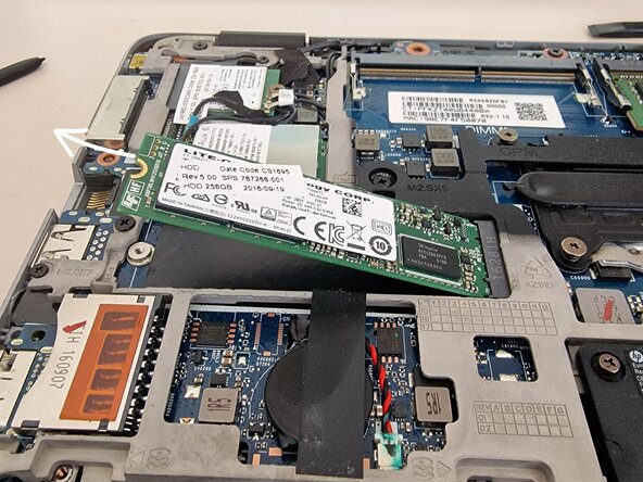

  4. ASUS Laptop Battery, SSD, and RAM Removal, Remove the SSD: crwdns2935265:04crwdnd2935265:01crwdnd2935265:02crwdne2935265:0 ASUS Laptop Battery, SSD, and RAM Removal, Remove the SSD: crwdns2935265:04crwdnd2935265:02crwdnd2935265:02crwdne2935265:0
    • Remove the single screw holding the SSD in place.
    • It's very small — don’t lose it.
    • Pull the SSD out in the direction it’s facing (usually upward at a slight angle).
    • Avoid bending or twisting the drive during removal.
