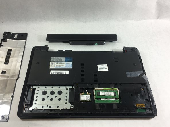

    • Flip the laptop over so you can see the battery.
  2. ASUS K53E-BBR1 RAM Replacement: crwdns2935265:02crwdnd2935265:01crwdnd2935265:01crwdne2935265:0
    • Slide the lock on the right side of the battery to the right. If done correctly the slider will stay in place and there will be a red indicator.
  3. ASUS K53E-BBR1 RAM Replacement: crwdns2935265:03crwdnd2935265:01crwdnd2935265:03crwdne2935265:0 ASUS K53E-BBR1 RAM Replacement: crwdns2935265:03crwdnd2935265:02crwdnd2935265:03crwdne2935265:0 ASUS K53E-BBR1 RAM Replacement: crwdns2935265:03crwdnd2935265:03crwdnd2935265:03crwdne2935265:0
    • Slide the other sliding lock on the left side of the battery to the left, and with your other hand slide the battery out from the laptop.

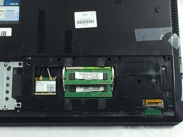

  4. ASUS K53E-BBR1 RAM Replacement, RAM: crwdns2935265:04crwdnd2935265:01crwdnd2935265:02crwdne2935265:0 ASUS K53E-BBR1 RAM Replacement, RAM: crwdns2935265:04crwdnd2935265:02crwdnd2935265:02crwdne2935265:0
    • Remove the two 4mm Phillips #0 screws located on the opposite ends of the laptop.

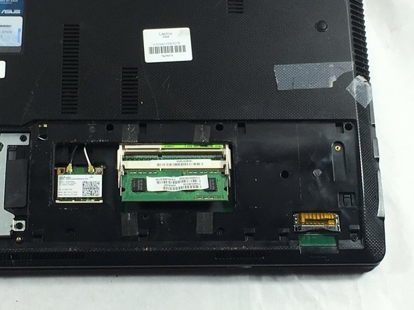

  5. ASUS K53E-BBR1 RAM Replacement: crwdns2935265:05crwdnd2935265:01crwdnd2935265:02crwdne2935265:0 ASUS K53E-BBR1 RAM Replacement: crwdns2935265:05crwdnd2935265:02crwdnd2935265:02crwdne2935265:0
    • Slide the back panel backwards until it stops.
    • You can now lift the panel up and out of the laptop casing.

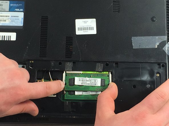

  6. ASUS K53E-BBR1 RAM Replacement: crwdns2935265:06crwdnd2935265:01crwdnd2935265:03crwdne2935265:0 ASUS K53E-BBR1 RAM Replacement: crwdns2935265:06crwdnd2935265:02crwdnd2935265:03crwdne2935265:0 ASUS K53E-BBR1 RAM Replacement: crwdns2935265:06crwdnd2935265:03crwdnd2935265:03crwdne2935265:0
    • The RAM is now visible.
    • Remove the RAM by pressing out on both tabs visible on each side of the RAM.
    • To work the tabs, take your finger tips and press outwards from the indents on the RAM.

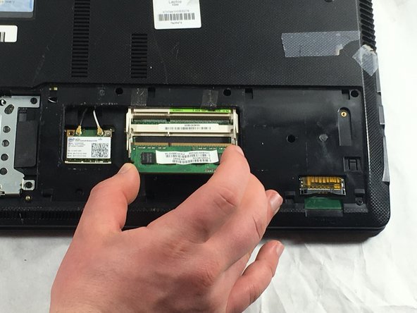

  7. ASUS K53E-BBR1 RAM Replacement: crwdns2935265:07crwdnd2935265:01crwdnd2935265:02crwdne2935265:0 ASUS K53E-BBR1 RAM Replacement: crwdns2935265:07crwdnd2935265:02crwdnd2935265:02crwdne2935265:0
    • The RAM is now angled up and you can remove the RAM by pulling it out in the direction it is facing.
    • Gently Pull the RAM out of its connector without pushing down or pulling up.

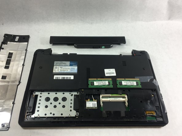

  8. ASUS K53E-BBR1 RAM Replacement: crwdns2935265:08crwdnd2935265:01crwdnd2935265:03crwdne2935265:0 ASUS K53E-BBR1 RAM Replacement: crwdns2935265:08crwdnd2935265:02crwdnd2935265:03crwdne2935265:0 ASUS K53E-BBR1 RAM Replacement: crwdns2935265:08crwdnd2935265:03crwdnd2935265:03crwdne2935265:0
    • Repeat the previous two steps for the second stick of RAM.
