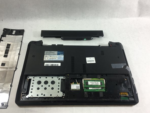

  6. ASUS K53E-BBR1 Hard Drive Replacement: crwdns2935265:06crwdnd2935265:01crwdnd2935265:01crwdne2935265:0
    • Remove the four 3mm Phillips #0 screws holding the hard drive in place.
  7. ASUS K53E-BBR1 Hard Drive Replacement: crwdns2935265:07crwdnd2935265:01crwdnd2935265:01crwdne2935265:0
    • Disconnect the hard drive from the laptop by sliding it towards the outside edge.

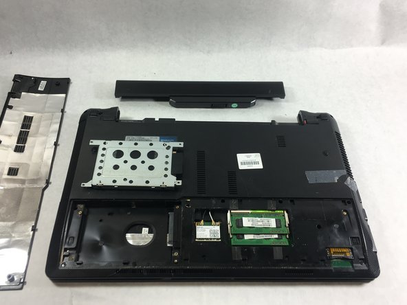

  8. ASUS K53E-BBR1 Hard Drive Replacement: crwdns2935265:08crwdnd2935265:01crwdnd2935265:02crwdne2935265:0 ASUS K53E-BBR1 Hard Drive Replacement: crwdns2935265:08crwdnd2935265:02crwdnd2935265:02crwdne2935265:0
    • Grab hold of the black cloth tab and pull the hard drive out from the laptop.
