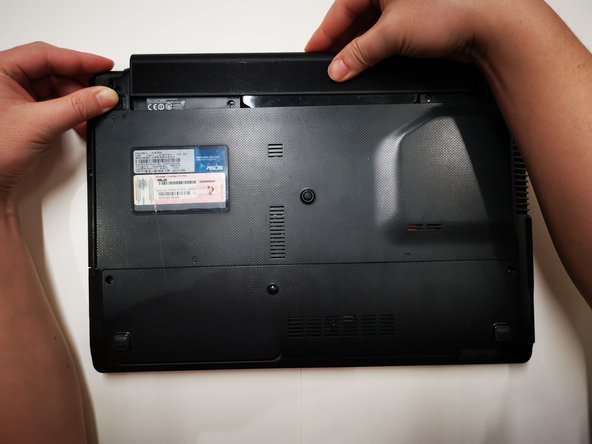

  3. ASUS K43SV SSD Replacement: crwdns2935265:03crwdnd2935265:01crwdnd2935265:03crwdne2935265:0 ASUS K43SV SSD Replacement: crwdns2935265:03crwdnd2935265:02crwdnd2935265:03crwdne2935265:0 ASUS K43SV SSD Replacement: crwdns2935265:03crwdnd2935265:03crwdnd2935265:03crwdne2935265:0
    • With your left hand, slide the latch on the left side of the battery to the left and hold it.
    • With your right hand, slide the battery out of the battery compartment and place the battery away from the laptop.

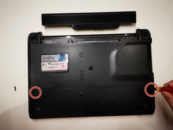

  4. ASUS K43SV SSD Replacement: crwdns2935265:04crwdnd2935265:01crwdnd2935265:02crwdne2935265:0 ASUS K43SV SSD Replacement: crwdns2935265:04crwdnd2935265:02crwdnd2935265:02crwdne2935265:0
    • Remove the two screws on the bottom of the laptop using a Phillips #0 screwdriver.
