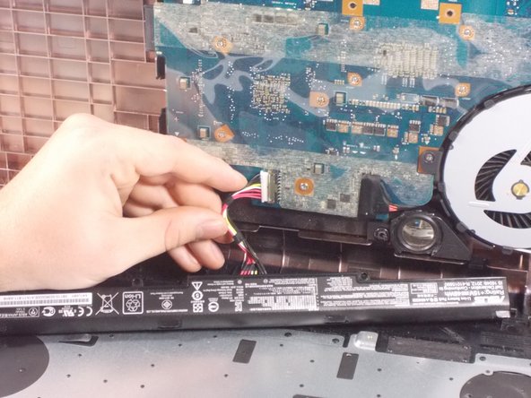

  5. ASUS GL752VW-DH74 Screen Replacement: crwdns2935265:05crwdnd2935265:01crwdnd2935265:01crwdne2935265:0
    • Unscrew the two 8mm screws attached to the battery
  6. ASUS GL752VW-DH74 Screen Replacement: crwdns2935265:06crwdnd2935265:01crwdnd2935265:01crwdne2935265:0
    • Disconnect the bundled cable connector and remove the battery.
