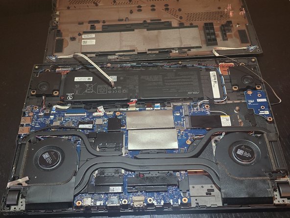

    • Warning: Do not touch any other components inside if you don't have to. It may result in damage and can destroy your laptop.
    • Remove the seven large screws using a Phillips #00 screwdriver.
    • Remove the four small screws using a Phillips #00 screwdriver.
    • Carefully lift the lid, being careful of the two cables connected to the laptop.

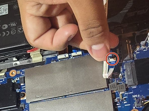

  2. ASUS G713RC RAM Replacement: crwdns2935265:02crwdnd2935265:01crwdnd2935265:03crwdne2935265:0 ASUS G713RC RAM Replacement: crwdns2935265:02crwdnd2935265:02crwdnd2935265:03crwdne2935265:0 ASUS G713RC RAM Replacement: crwdns2935265:02crwdnd2935265:03crwdnd2935265:03crwdne2935265:0
    • Carefully detach the two white cables that are connected to the lid.
    • Set aside the lid.
  3. ASUS G713RC RAM Replacement: crwdns2935265:03crwdnd2935265:01crwdnd2935265:03crwdne2935265:0 ASUS G713RC RAM Replacement: crwdns2935265:03crwdnd2935265:02crwdnd2935265:03crwdne2935265:0 ASUS G713RC RAM Replacement: crwdns2935265:03crwdnd2935265:03crwdnd2935265:03crwdne2935265:0
    • Carefully lift up each gray bar.
    • It is important that you don't completely remove the gray bar.
    • Remove the RAM.
  4. ASUS G713RC RAM Replacement: crwdns2935265:04crwdnd2935265:01crwdnd2935265:03crwdne2935265:0 ASUS G713RC RAM Replacement: crwdns2935265:04crwdnd2935265:02crwdnd2935265:03crwdne2935265:0 ASUS G713RC RAM Replacement: crwdns2935265:04crwdnd2935265:03crwdnd2935265:03crwdne2935265:0
    • Insert each RAM stick under the gray bar. Push until you hear a click.
    • Hold down the gray bar to make sure it is flat and secure.
    • It might be a bit bumpy, but it is nothing to worry about.
  5. ASUS G713RC RAM Replacement: crwdns2935265:05crwdnd2935265:01crwdnd2935265:02crwdne2935265:0 ASUS G713RC RAM Replacement: crwdns2935265:05crwdnd2935265:02crwdnd2935265:02crwdne2935265:0
    • Reattach the lid by connecting the white wires to the base.
    • Plug in the white wires on both sides. You want to plug them in thoroughly, otherwise, your laptop won't turn on.
