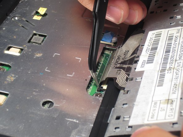

    • Open the laptop so that you can see the keyboard.
    • Unlock the three keyboard tabs by pushing down on the silver tabs with a Spudger.
  2. ASUS Eee PC 900HD Key Board Replacement: crwdns2935265:02crwdnd2935265:01crwdnd2935265:02crwdne2935265:0 ASUS Eee PC 900HD Key Board Replacement: crwdns2935265:02crwdnd2935265:02crwdnd2935265:02crwdne2935265:0
    • With the plastic opening tool, you will carefully lift up the keyboard.
  3. ASUS Eee PC 900HD Key Board Replacement: crwdns2935265:03crwdnd2935265:01crwdnd2935265:02crwdne2935265:0 ASUS Eee PC 900HD Key Board Replacement: crwdns2935265:03crwdnd2935265:02crwdnd2935265:02crwdne2935265:0
    • Using a pair of tweezers, disconnect the cable at the bottom of the keyboard by flipping the two lock switches up on both sides of the cable.
  4. ASUS Eee PC 900HD Key Board Replacement: crwdns2935265:04crwdnd2935265:01crwdnd2935265:01crwdne2935265:0
    • Carefully pull the cable out.
    • You are now able to disconnect the keyboard from its origin.
