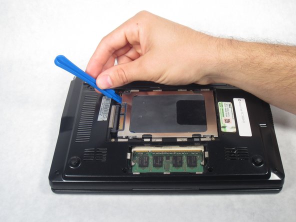

    • Starting from the left, use a plastic opening tool to slide the hard drive all the way to the right.

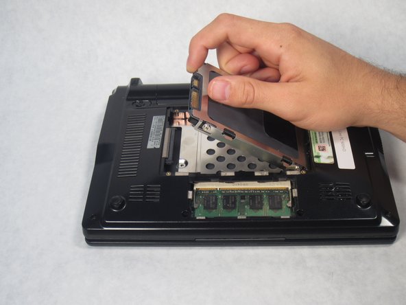

    • Once the hard drive is completely to the right, pull up on the hard drive to remove.
