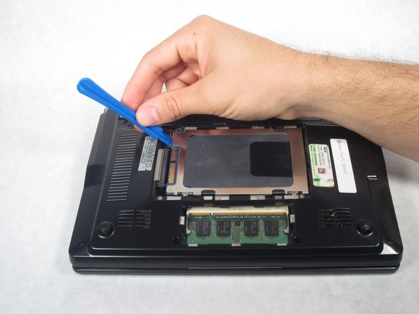

  3. ASUS Eee PC 900HD Clicker Replacement: crwdns2935265:03crwdnd2935265:01crwdnd2935265:02crwdne2935265:0 ASUS Eee PC 900HD Clicker Replacement: crwdns2935265:03crwdnd2935265:02crwdnd2935265:02crwdne2935265:0

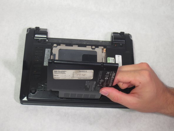

    • Using a plastic opening tool, take off the hard drive cover by lifting it up.

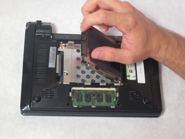

  4. ASUS Eee PC 900HD Clicker Replacement: crwdns2935265:04crwdnd2935265:01crwdnd2935265:03crwdne2935265:0 ASUS Eee PC 900HD Clicker Replacement: crwdns2935265:04crwdnd2935265:02crwdnd2935265:03crwdne2935265:0 ASUS Eee PC 900HD Clicker Replacement: crwdns2935265:04crwdnd2935265:03crwdnd2935265:03crwdne2935265:0
    • Starting from the left, use a plastic opening tool to slide the hard drive all the way to the right.
    • Once the hard drive is all the way to the right, lift it up and pull it out.

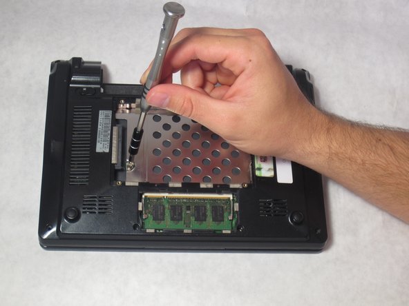

  5. ASUS Eee PC 900HD Clicker Replacement: crwdns2935265:05crwdnd2935265:01crwdnd2935265:02crwdne2935265:0 ASUS Eee PC 900HD Clicker Replacement: crwdns2935265:05crwdnd2935265:02crwdnd2935265:02crwdne2935265:0
    • Remove the screw under the hard drive using the Phillips J0 Screwdriver.

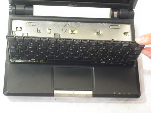

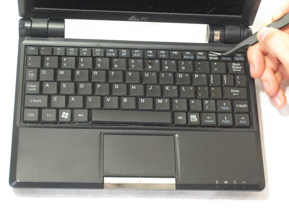

    • Flip the laptop back over and unlock the three keyboard tabs at the top of the keyboard by pushing down on the silver tabs with tweezers .
  7. ASUS Eee PC 900HD Clicker Replacement: crwdns2935265:07crwdnd2935265:01crwdnd2935265:02crwdne2935265:0 ASUS Eee PC 900HD Clicker Replacement: crwdns2935265:07crwdnd2935265:02crwdnd2935265:02crwdne2935265:0
    • Use the plastic opening tool to lift up the keyboard.

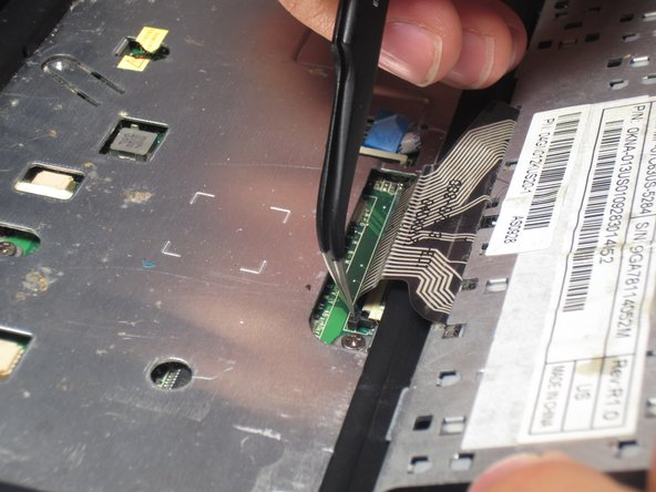

    • Using a pair of tweezers, disconnect the cable at the bottom of the keyboard by flipping the two lock switches up on both sides of the cable.
    • Carefully pull the cable out.

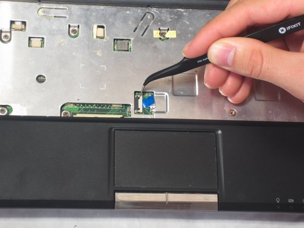

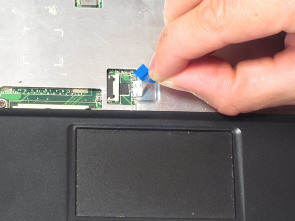

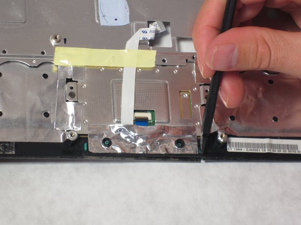

    • Using a pair of tweezers, unlock the touchpad ribbon by pushing the white lock tab to the right.
    • Carefully pull the ribbon to the right.

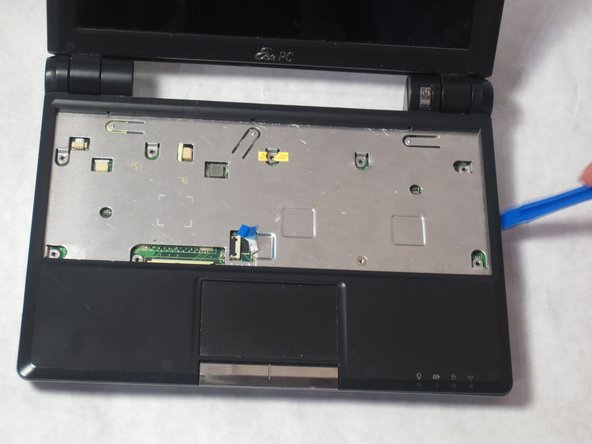

  10. ASUS Eee PC 900HD Clicker Replacement: crwdns2935265:010crwdnd2935265:01crwdnd2935265:03crwdne2935265:0 ASUS Eee PC 900HD Clicker Replacement: crwdns2935265:010crwdnd2935265:02crwdnd2935265:03crwdne2935265:0 ASUS Eee PC 900HD Clicker Replacement: crwdns2935265:010crwdnd2935265:03crwdnd2935265:03crwdne2935265:0

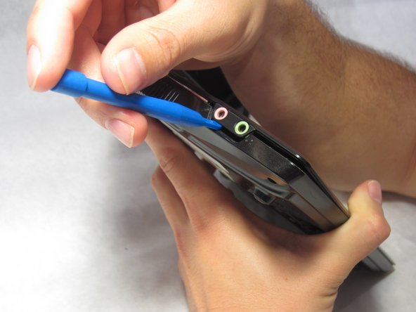

    • Remove the nine 4.76 mm screws from the top cover of the laptop using the Phillips J0 Screwdriver.
    • Using a plastic opening tool, pry up the edges of the cover.
    • Caution: Be careful around the audio and microphone jacks as they can be easily damaged. Lift the right half of the cover and move it towards the left.

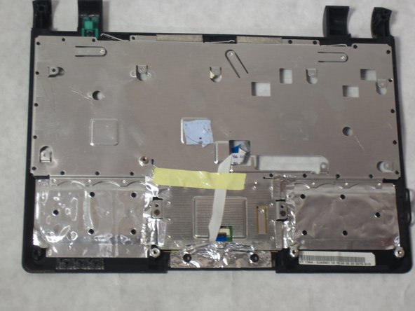

  11. ASUS Eee PC 900HD Clicker Replacement: crwdns2935265:011crwdnd2935265:01crwdnd2935265:02crwdne2935265:0 ASUS Eee PC 900HD Clicker Replacement: crwdns2935265:011crwdnd2935265:02crwdnd2935265:02crwdne2935265:0
    • Lift up and remove the top cover of the laptop.
    • Flip this cover over to reveal the back.
  12. ASUS Eee PC 900HD Clicker Replacement: crwdns2935265:012crwdnd2935265:01crwdnd2935265:03crwdne2935265:0 ASUS Eee PC 900HD Clicker Replacement: crwdns2935265:012crwdnd2935265:02crwdnd2935265:03crwdne2935265:0 ASUS Eee PC 900HD Clicker Replacement: crwdns2935265:012crwdnd2935265:03crwdnd2935265:03crwdne2935265:0

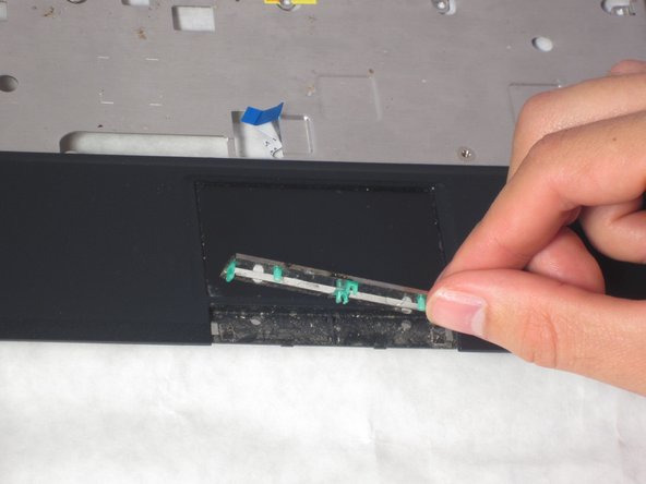

    • Using a Spudger, push down on the green tabs found on both sides.
    • Pull the clicker off of the cover plate.
