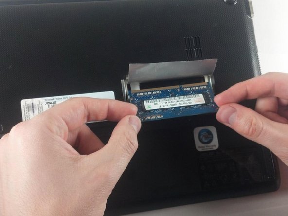

  7. ASUS Eee PC 1018P RAM Replacement: crwdns2935265:07crwdnd2935265:01crwdnd2935265:02crwdne2935265:0 ASUS Eee PC 1018P RAM Replacement: crwdns2935265:07crwdnd2935265:02crwdnd2935265:02crwdne2935265:0
    • Carefully grasping the edges of the RAM module, slowly pull it free from the pin connectors underneath the edge of the foil.
    • Pull the RAM out at the same angle that it pops up naturally to. Ripping the RAM free at other angles can damage the fragile pins.
  8. ASUS Eee PC 1018P RAM Replacement: crwdns2935265:08crwdnd2935265:01crwdnd2935265:01crwdne2935265:0
    • Remove RAM module entirely for repair or replacement.
