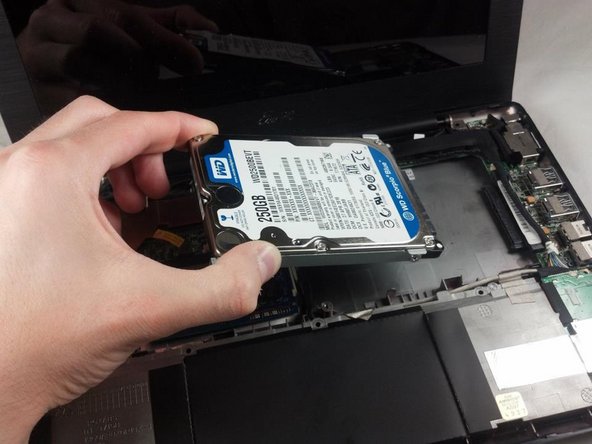

  12. ASUS Eee PC 1018P Hard Drive Replacement: crwdns2935265:012crwdnd2935265:01crwdnd2935265:03crwdne2935265:0 ASUS Eee PC 1018P Hard Drive Replacement: crwdns2935265:012crwdnd2935265:02crwdnd2935265:03crwdne2935265:0 ASUS Eee PC 1018P Hard Drive Replacement: crwdns2935265:012crwdnd2935265:03crwdnd2935265:03crwdne2935265:0
    • Lift the left side of the hard drive slightly. Gently pull the hard drive to the left in order to free it from the pin connection on the right side.
    • Continue pulling the hard drive out from the socket until it's free from the rest of the laptop.
    • Removing the hard drive at too great or too small an angle can cause damage to both the hard drive and the connector to the motherboard.

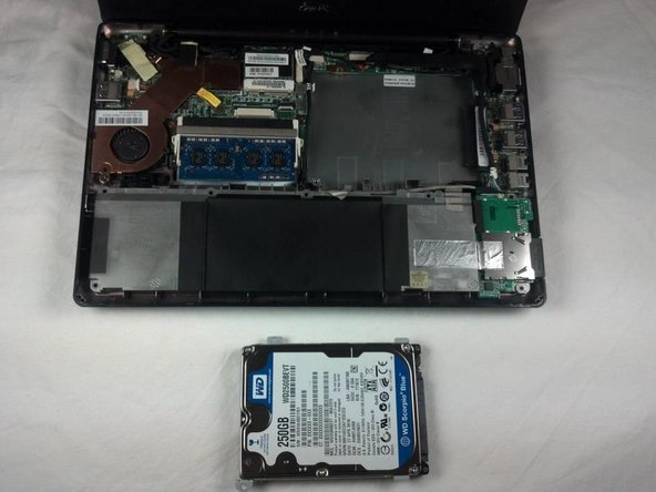

  13. ASUS Eee PC 1018P Hard Drive Replacement: crwdns2935265:013crwdnd2935265:01crwdnd2935265:01crwdne2935265:0
    • Use a Phillips #0 screwdriver to remove the four 3.68 mm screws securing the hard drive case to the hard drive. There are two on each side of the hard drive case.
  14. ASUS Eee PC 1018P Hard Drive Replacement: crwdns2935265:014crwdnd2935265:01crwdnd2935265:01crwdne2935265:0
    • The hard drive is now fully removed and ready to be replaced.
