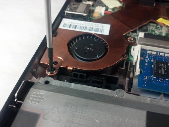

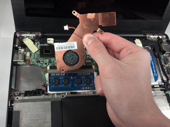

  10. ASUS Eee PC 1018P Fan Replacement, Fan: crwdns2935265:010crwdnd2935265:01crwdnd2935265:02crwdne2935265:0 ASUS Eee PC 1018P Fan Replacement, Fan: crwdns2935265:010crwdnd2935265:02crwdnd2935265:02crwdne2935265:0
    • Use a Phillips #0 screwdriver to remove the two 3.76 mm screws securing the fan/heat sink assembly to the motherboard.

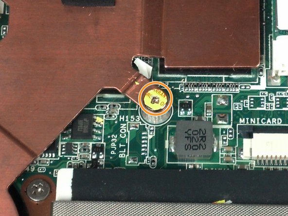

  11. ASUS Eee PC 1018P Fan Replacement: crwdns2935265:011crwdnd2935265:01crwdnd2935265:02crwdne2935265:0 ASUS Eee PC 1018P Fan Replacement: crwdns2935265:011crwdnd2935265:02crwdnd2935265:02crwdne2935265:0
    • An additional 3.76 mm Phillips screw is hidden under the seal that reads, "WARRANTY VOID IF SEAL BROKEN OR REMOVED." Remove this sticker to access the screw.
    • Use a Phillips #0 screwdriver to remove the screw.

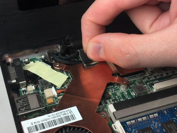

  12. ASUS Eee PC 1018P Fan Replacement: crwdns2935265:012crwdnd2935265:01crwdnd2935265:01crwdne2935265:0
    • Using the spudger, gently push at the top and bottom ridges of this wire bus to disconnect it from the socket.
  13. ASUS Eee PC 1018P Fan Replacement: crwdns2935265:013crwdnd2935265:01crwdnd2935265:01crwdne2935265:0
    • Slide the spudger under the righthand edge of the copper heat sink in order to disconnect it from the thermal pad below.

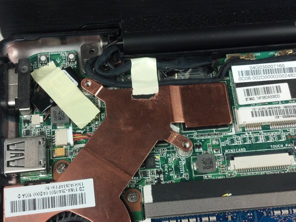

  14. ASUS Eee PC 1018P Fan Replacement: crwdns2935265:014crwdnd2935265:01crwdnd2935265:03crwdne2935265:0 ASUS Eee PC 1018P Fan Replacement: crwdns2935265:014crwdnd2935265:02crwdnd2935265:03crwdne2935265:0 ASUS Eee PC 1018P Fan Replacement: crwdns2935265:014crwdnd2935265:03crwdnd2935265:03crwdne2935265:0
    • Peel the foam adhesive pad off from the top of the copper plate, as well as the tape located beneath that.

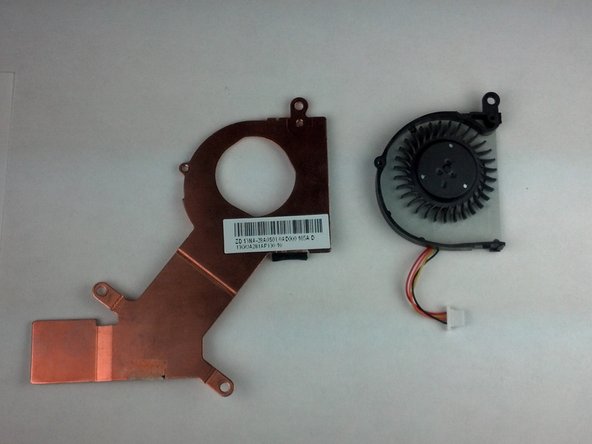

  15. ASUS Eee PC 1018P Fan Replacement: crwdns2935265:015crwdnd2935265:01crwdnd2935265:02crwdne2935265:0 ASUS Eee PC 1018P Fan Replacement: crwdns2935265:015crwdnd2935265:02crwdnd2935265:02crwdne2935265:0
    • Gently remove the fan.
  16. ASUS Eee PC 1018P Fan Replacement: crwdns2935265:016crwdnd2935265:01crwdnd2935265:01crwdne2935265:0
    • Use a Phillips #0 screwdriver to remove the two 2.35 mm screws securing the fan to the copper plate.

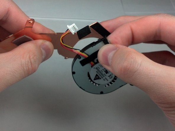

  17. ASUS Eee PC 1018P Fan Replacement: crwdns2935265:017crwdnd2935265:01crwdnd2935265:03crwdne2935265:0 ASUS Eee PC 1018P Fan Replacement: crwdns2935265:017crwdnd2935265:02crwdnd2935265:03crwdne2935265:0 ASUS Eee PC 1018P Fan Replacement: crwdns2935265:017crwdnd2935265:03crwdnd2935265:03crwdne2935265:0
    • Gripping the fan with one hand and the copper plate with the other, gently pull them apart.
    • The fan is now fully removed.
