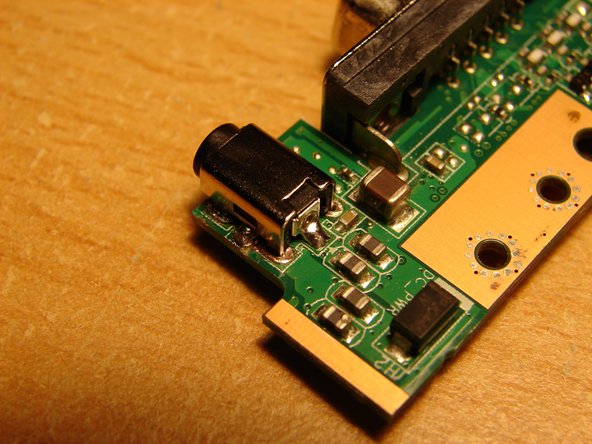

    10. ASUS Eee PC 1001PX Charging Socket Replacement, Assessing the Broken Charging Plug: crwdns2935265:010crwdnd2935265:01crwdnd2935265:02crwdne2935265:0 ASUS Eee PC 1001PX Charging Socket Replacement, Assessing the Broken Charging Plug: crwdns2935265:010crwdnd2935265:02crwdnd2935265:02crwdne2935265:0
      • After having removed the mainboard, you need to turn it. You will now see the broken charging plug to the right of the VGA port.
      • Assess the damage. The charging plug you see here cannot be repaired any more but needs to be replaced.
      • The charging plug is soldered to the PCB professionally. So, you might want to take some extra time for the next step(s).

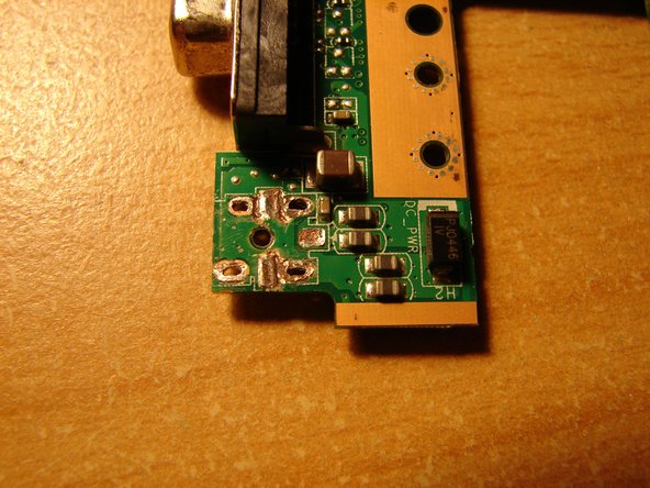

    11. ASUS Eee PC 1001PX Charging Socket Replacement, Replacing the Charging Plug 1/2: crwdns2935265:011crwdnd2935265:01crwdnd2935265:03crwdne2935265:0 ASUS Eee PC 1001PX Charging Socket Replacement, Replacing the Charging Plug 1/2: crwdns2935265:011crwdnd2935265:02crwdnd2935265:03crwdne2935265:0 ASUS Eee PC 1001PX Charging Socket Replacement, Replacing the Charging Plug 1/2: crwdns2935265:011crwdnd2935265:03crwdnd2935265:03crwdne2935265:0
      • Use a soldering iron or soldering station to unsolder the broken charging plug.
      • Keep in mind that the solder used by ASUS is industrial solder. Therefore, it needs a soldering iron or soldering station of at least 40 W. A mini soldering iron with 15 W will not do!
      • In case you do not have such a powerful soldering station or soldering iron, you can use a mini drill to mechanically remove the charging plug one piece at a time. This takes time, but when done successfully, you can then unsolder what is left of the charging plug, for example the legs on the PCB.
      • Again: Take your time with the unsoldering process. Also, don't put too much physical pressure on the PCB area around the charging plug. The PCB could break at that place when pushed too much.
      • One important tip: Use desoldering wick while unsoldering the charging plug. The wick will soak in melted solder. When the broken charging unit is successfully removed, use desoldering wick again to clean all solder joints of the pins of the charging plug on the PCB.
    12. ASUS Eee PC 1001PX Charging Socket Replacement, Replacing the Charging Plug 2/2: crwdns2935265:012crwdnd2935265:01crwdnd2935265:03crwdne2935265:0 ASUS Eee PC 1001PX Charging Socket Replacement, Replacing the Charging Plug 2/2: crwdns2935265:012crwdnd2935265:02crwdnd2935265:03crwdne2935265:0 ASUS Eee PC 1001PX Charging Socket Replacement, Replacing the Charging Plug 2/2: crwdns2935265:012crwdnd2935265:03crwdnd2935265:03crwdne2935265:0
      • Congrats! You have successfully removed the old charging plug. Now, put some new solder onto the cleaned solder joints - but just a bit, not too much! Pay attention that the openings of each solder joint of the charging plug remain open!
      • The moment has come to put in the new charging plug. One very important advice before you start soldering: Start soldering on the top side of the PCB, not on the bottom side! This is critical since the two middle pins of the new charging plug need to be soldered first, including the pin on the back side of the charging plug.
      • Now push the new charging plug into the openings (again: on topside of the PCB!). Next, decide, which middle pin you want to solder first (right or left?).
      • Gently push either the right or the left side of the charging plug down with a wooden part (since the metal part of the charging unit gets really hot!) while you are soldering this pin (this is why we prepared the solder joints with a bit of new solder). Do the same with the other middle pin and finally with the pin on the back side.
      • Now take care of the legs of the charging plug on top of the PCB. Give all solder joints a final touch before you finally turn the PCB and finish the soldering job there by soldering the four solder joints. Job done!!
