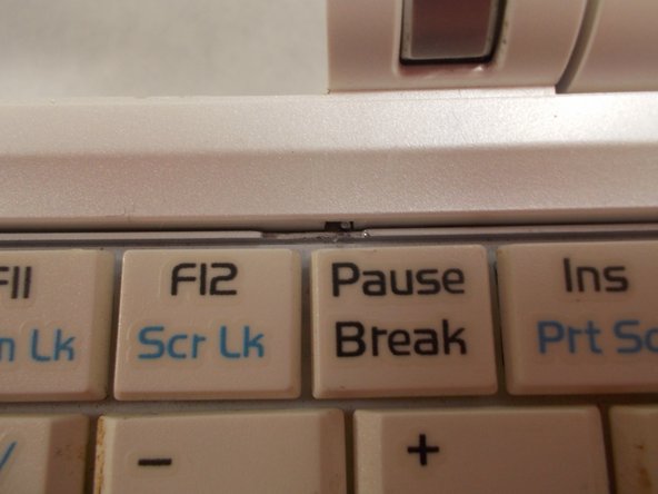

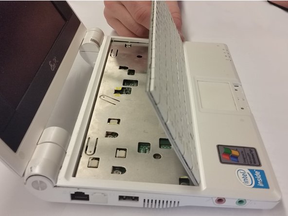

  3. ASUS EEE PC701SD-WHI004X Touchpad and/or Mouse Button Replacement, Keyboard: crwdns2935265:03crwdnd2935265:01crwdnd2935265:03crwdne2935265:0 ASUS EEE PC701SD-WHI004X Touchpad and/or Mouse Button Replacement, Keyboard: crwdns2935265:03crwdnd2935265:02crwdnd2935265:03crwdne2935265:0 ASUS EEE PC701SD-WHI004X Touchpad and/or Mouse Button Replacement, Keyboard: crwdns2935265:03crwdnd2935265:03crwdnd2935265:03crwdne2935265:0
    • Push the 3 tabs at the top of the keyboard in and down one at a time using a nylon spudger.
    • Once the three tabs have been pushed in, gently pry the top of the keyboard until it begins to hinge out of its slot.
    • The keyboard is still attached by a cable. Be careful when removing not to damage the cable. Do not yank the keyboard out.

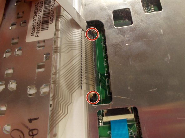

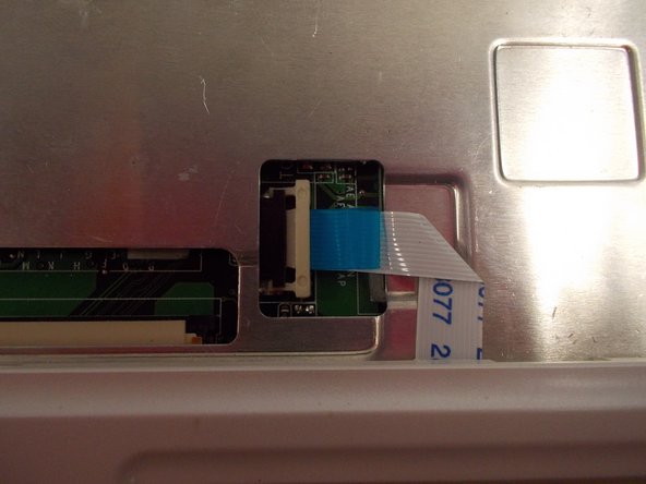

  4. ASUS EEE PC701SD-WHI004X Touchpad and/or Mouse Button Replacement: crwdns2935265:04crwdnd2935265:01crwdnd2935265:03crwdne2935265:0 ASUS EEE PC701SD-WHI004X Touchpad and/or Mouse Button Replacement: crwdns2935265:04crwdnd2935265:02crwdnd2935265:03crwdne2935265:0 ASUS EEE PC701SD-WHI004X Touchpad and/or Mouse Button Replacement: crwdns2935265:04crwdnd2935265:03crwdnd2935265:03crwdne2935265:0
    • Push the two sides of the ribbon cable connector away from yourself. This will unseat the ribbon cable.
    • Once the tabs are unseated, you can gently remove the ribbon cable by pulling it out of its slot. The keyboard can now be removed.
    • To be on the safe side, it’s better to use a nylon spudger, rather than the metal spudger shown in the picture.

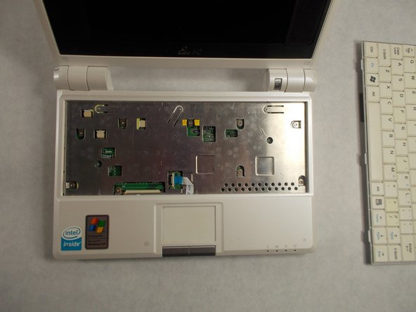

  5. ASUS EEE PC701SD-WHI004X Touchpad and/or Mouse Button Replacement, Touchpad and Mouse Buttons: crwdns2935265:05crwdnd2935265:01crwdnd2935265:01crwdne2935265:0
    • Remove all six 3.4mm Phillips #1 screws marked with red circles.

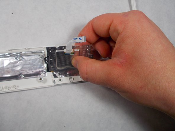

  9. ASUS EEE PC701SD-WHI004X Touchpad and/or Mouse Button Replacement: crwdns2935265:09crwdnd2935265:01crwdnd2935265:03crwdne2935265:0 ASUS EEE PC701SD-WHI004X Touchpad and/or Mouse Button Replacement: crwdns2935265:09crwdnd2935265:02crwdnd2935265:03crwdne2935265:0 ASUS EEE PC701SD-WHI004X Touchpad and/or Mouse Button Replacement: crwdns2935265:09crwdnd2935265:03crwdnd2935265:03crwdne2935265:0
    • Flip over the top cover and unscrew the two 1.2mm Phillips #0 screws.
    • Remove the plate and the trackpad. They may come off separately.
