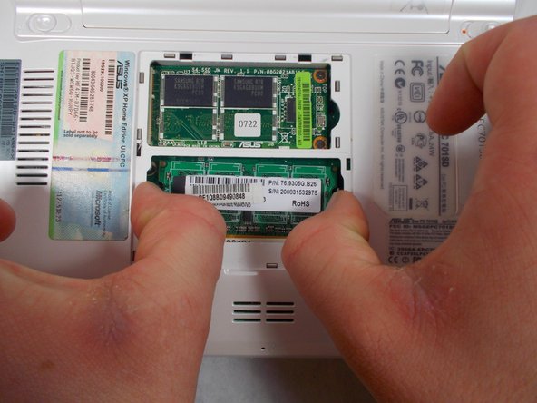

  4. ASUS EEE PC701SD-WHI004X RAM Replacement: crwdns2935265:04crwdnd2935265:01crwdnd2935265:03crwdne2935265:0 ASUS EEE PC701SD-WHI004X RAM Replacement: crwdns2935265:04crwdnd2935265:02crwdnd2935265:03crwdne2935265:0 ASUS EEE PC701SD-WHI004X RAM Replacement: crwdns2935265:04crwdnd2935265:03crwdnd2935265:03crwdne2935265:0
    • Gently push the metal tabs outwards, this will allow the RAM to pop up.
  5. ASUS EEE PC701SD-WHI004X RAM Replacement: crwdns2935265:05crwdnd2935265:01crwdnd2935265:02crwdne2935265:0 ASUS EEE PC701SD-WHI004X RAM Replacement: crwdns2935265:05crwdnd2935265:02crwdnd2935265:02crwdne2935265:0
    • Remove the RAM stick by grabbing it on the sides and gently pulling the stick out of its slot.
