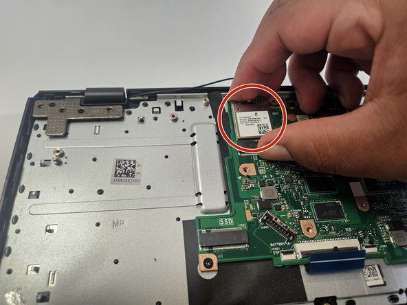

    • Place the laptop with the bottom side facing up. Have the front (where the touchpad is) facing toward you.
    • Start by removing the ten 7mm screws on the bottom of the laptop using a JIS #00 screwdriver.
  2. ASUS E210MA-TB.CL464BK Wi-Fi Card Replacement: crwdns2935265:02crwdnd2935265:01crwdnd2935265:01crwdne2935265:0
    • Double-check to make sure all of the screws are removed.
    • If you have a Jimmy or other flat, straight-edge object, slide it in the crack where the halves of the case meet.
    • When the parts are separated, pull them apart to expose the insides of the case.
  3. ASUS E210MA-TB.CL464BK Wi-Fi Card Replacement: crwdns2935265:03crwdnd2935265:01crwdnd2935265:02crwdne2935265:0 ASUS E210MA-TB.CL464BK Wi-Fi Card Replacement: crwdns2935265:03crwdnd2935265:02crwdnd2935265:02crwdne2935265:0
    • Locate the card and remove it by gently lifting it up and pulling it out.
