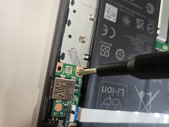

  3. ASUS E210MA-TB.CL464BK USB Port Replacement: crwdns2935265:03crwdnd2935265:01crwdnd2935265:02crwdne2935265:0 ASUS E210MA-TB.CL464BK USB Port Replacement: crwdns2935265:03crwdnd2935265:02crwdnd2935265:02crwdne2935265:0
    • Remove the four 2 mm screws from the USB PCB.
  4. ASUS E210MA-TB.CL464BK USB Port Replacement: crwdns2935265:04crwdnd2935265:01crwdnd2935265:01crwdne2935265:0
    • Unlatch the ribbon cable from the the USB port and remove the PCB.
