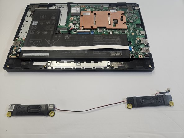

    • Remove the speakers as outlined in the speaker replacement guide, summarized below.
    • Remove the four 5mm screws, with a J00 screw driver.
    • Locate and remove the white plug by pulling it towards you.

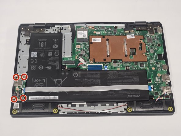

  4. ASUS E210MA-TB.CL464BK Touchpad Replacement: crwdns2935265:04crwdnd2935265:01crwdnd2935265:02crwdne2935265:0 ASUS E210MA-TB.CL464BK Touchpad Replacement: crwdns2935265:04crwdnd2935265:02crwdnd2935265:02crwdne2935265:0
    • Remove the usb port as outlined in the usb port replacement guide, summarized below.
    • Remove the four 5mm screws with a J00 screwdriver.
    • You do not *need* to fully unplug and remove the USB port, but at least it is out of the way.

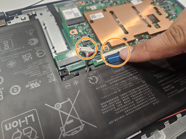

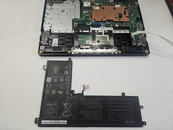

  5. ASUS E210MA-TB.CL464BK Touchpad Replacement: crwdns2935265:05crwdnd2935265:01crwdnd2935265:03crwdne2935265:0 ASUS E210MA-TB.CL464BK Touchpad Replacement: crwdns2935265:05crwdnd2935265:02crwdnd2935265:03crwdne2935265:0 ASUS E210MA-TB.CL464BK Touchpad Replacement: crwdns2935265:05crwdnd2935265:03crwdnd2935265:03crwdne2935265:0
    • Remove the battery as described in the battery replacement guide, summarized below.
    • Remove the five 5mm screws securing the battery with a J00 screwdriver.
    • Unplug and disconnect the tape.

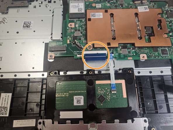

  6. ASUS E210MA-TB.CL464BK Touchpad Replacement: crwdns2935265:06crwdnd2935265:01crwdnd2935265:02crwdne2935265:0 ASUS E210MA-TB.CL464BK Touchpad Replacement: crwdns2935265:06crwdnd2935265:02crwdnd2935265:02crwdne2935265:0
    • Identify the touchpad at the front of the case.
    • Unplug and remove the tape from the top of the touchpad.
  7. ASUS E210MA-TB.CL464BK Touchpad Replacement: crwdns2935265:07crwdnd2935265:01crwdnd2935265:02crwdne2935265:0 ASUS E210MA-TB.CL464BK Touchpad Replacement: crwdns2935265:07crwdnd2935265:02crwdnd2935265:02crwdne2935265:0
    • Remove the three 5mm screws from the top of the touchpad with a J00 screwdriver.

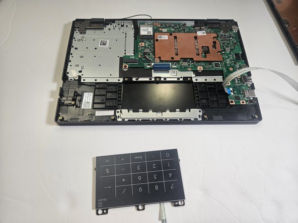

  8. ASUS E210MA-TB.CL464BK Touchpad Replacement: crwdns2935265:08crwdnd2935265:01crwdnd2935265:02crwdne2935265:0 ASUS E210MA-TB.CL464BK Touchpad Replacement: crwdns2935265:08crwdnd2935265:02crwdnd2935265:02crwdne2935265:0
    • Slide out the touchpad from under the metal bracket.pinching the top and sliding it forward and up.
