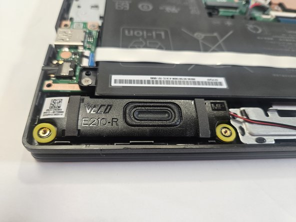

  3. ASUS E210MA-TB.CL464BK Speaker Replacement: crwdns2935265:03crwdnd2935265:01crwdnd2935265:03crwdne2935265:0 ASUS E210MA-TB.CL464BK Speaker Replacement: crwdns2935265:03crwdnd2935265:02crwdnd2935265:03crwdne2935265:0 ASUS E210MA-TB.CL464BK Speaker Replacement: crwdns2935265:03crwdnd2935265:03crwdnd2935265:03crwdne2935265:0
    • Remove the four 5mm screws on the speakers.
    • Pop out speakers gently.

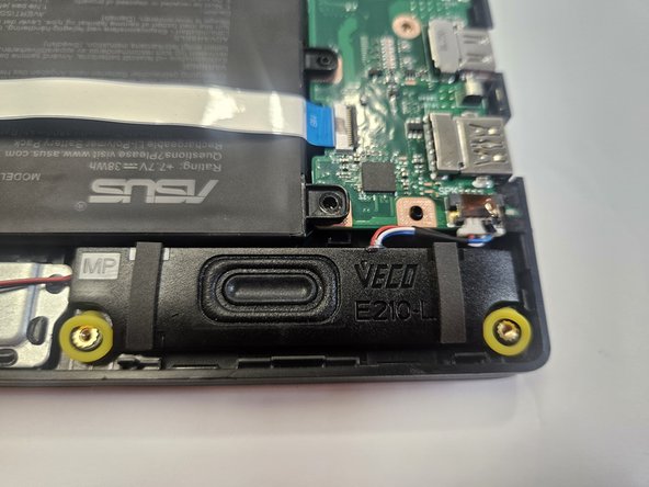

  4. ASUS E210MA-TB.CL464BK Speaker Replacement: crwdns2935265:04crwdnd2935265:01crwdnd2935265:01crwdne2935265:0
    • Locate the white plug, it should be above the right speaker.
    • Remove the white plug by pulling it towards you.

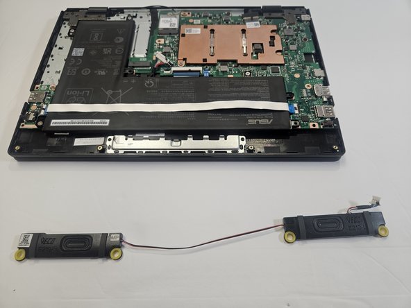

  5. ASUS E210MA-TB.CL464BK Speaker Replacement: crwdns2935265:05crwdnd2935265:01crwdnd2935265:02crwdne2935265:0 ASUS E210MA-TB.CL464BK Speaker Replacement: crwdns2935265:05crwdnd2935265:02crwdnd2935265:02crwdne2935265:0
    • Carefully remove the speakers.
