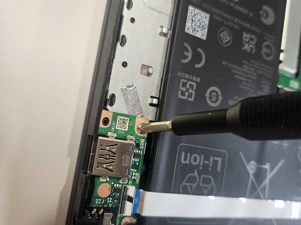

    • Remove the 4 mm screws around the USB port.
  4. ASUS E210MA-TB.CL464BK Battery Replacement: crwdns2935265:04crwdnd2935265:01crwdnd2935265:02crwdne2935265:0 ASUS E210MA-TB.CL464BK Battery Replacement: crwdns2935265:04crwdnd2935265:02crwdnd2935265:02crwdne2935265:0
    • Remove the 3 mm screws around the battery.
    • Carefully lift up the USB port and set it to the side.

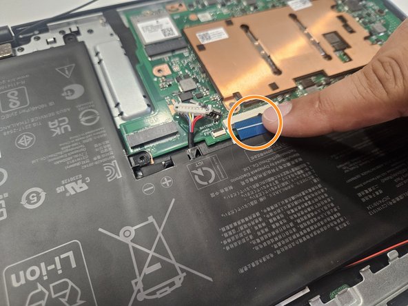

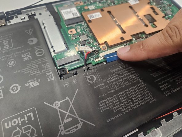

    • Unplug the connection between the motherboard and the battery by pulling towards the speaker side.
    • Repeat the same process to remove the blue tape on the second picture.
  6. ASUS E210MA-TB.CL464BK Battery Replacement: crwdns2935265:06crwdnd2935265:01crwdnd2935265:01crwdne2935265:0
    • Lift up and remove the battery.
