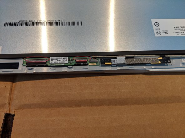

  3. ASUS Chromebook Flip C302CA-DHM4 LCD Digitizer w/ Bezel Replacement, Disconnect Digitizer: crwdns2935265:03crwdnd2935265:01crwdnd2935265:03crwdne2935265:0 ASUS Chromebook Flip C302CA-DHM4 LCD Digitizer w/ Bezel Replacement, Disconnect Digitizer: crwdns2935265:03crwdnd2935265:02crwdnd2935265:03crwdne2935265:0 ASUS Chromebook Flip C302CA-DHM4 LCD Digitizer w/ Bezel Replacement, Disconnect Digitizer: crwdns2935265:03crwdnd2935265:03crwdnd2935265:03crwdne2935265:0
    • To remove the thin cables for the digitizer, you must first open the fastener by flipping the off-white plastic edge closest to the LCD towards the outside edge of the frame.
    • Once the fasteners have been opened, use two spudgers to remove each cable by unfolding and dragging them back towards the outside edge of the frame.
    • To release circuit board, use a spudger tool to pry the gray clip back. Gently pull up on the left edge of the circuit board.
    • The right edge of the circuit board is glued down. Using a spudger, pry up on the right edge to free it from the frame display.

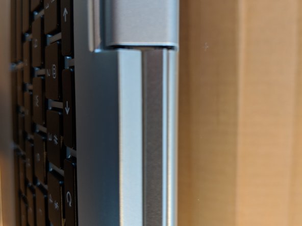

  5. ASUS Chromebook Flip C302CA-DHM4 LCD Digitizer w/ Bezel Replacement, Replace and Reassemble Display: crwdns2935265:05crwdnd2935265:01crwdnd2935265:02crwdne2935265:0 ASUS Chromebook Flip C302CA-DHM4 LCD Digitizer w/ Bezel Replacement, Replace and Reassemble Display: crwdns2935265:05crwdnd2935265:02crwdnd2935265:02crwdne2935265:0
    • Follow the previous steps to replace the display just as you've removed it. Take care to ensure the LCD and Digitizer/Webcam cables are properly seated in the channels before sealing the lid.
    • When the laptop lid is sealed, the hinge edge will lay uniformly flat.
