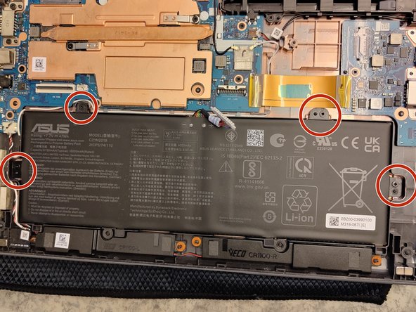

  2. ASUS Chromebook CR1 (CR1100) Teardown, Remove battery: crwdns2935265:03crwdnd2935265:01crwdnd2935265:03crwdne2935265:0 ASUS Chromebook CR1 (CR1100) Teardown, Remove battery: crwdns2935265:03crwdnd2935265:02crwdnd2935265:03crwdne2935265:0 ASUS Chromebook CR1 (CR1100) Teardown, Remove battery: crwdns2935265:03crwdnd2935265:03crwdnd2935265:03crwdne2935265:0
    • Move the metal bracket on the battery connector away from the white plastic that is the battery cable contact.
    • Lift the white plastic contact away from the battery connector.
    • Remove 4 screws.
    • Remove battery by sliding it up and away from the bottom. (4 plastic pins keep it from falling out)

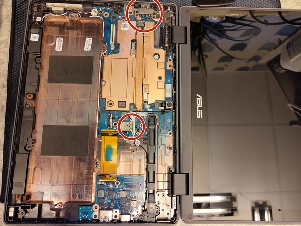

  3. ASUS Chromebook CR1 (CR1100) Teardown, Remove screen assembly: crwdns2935265:04crwdnd2935265:01crwdnd2935265:03crwdne2935265:0 ASUS Chromebook CR1 (CR1100) Teardown, Remove screen assembly: crwdns2935265:04crwdnd2935265:02crwdnd2935265:03crwdne2935265:0 ASUS Chromebook CR1 (CR1100) Teardown, Remove screen assembly: crwdns2935265:04crwdnd2935265:03crwdnd2935265:03crwdne2935265:0
    • Remove two screws holding down a USB-A cover. The lower one in the picture is a M2.0 and the upper is a M2.5. Then remove the metal cover.
    • Remove display ribbon cable. There is a latch under the plastic film.
    • The black antenna connector (white is removed in the next step) has a hard plastic cover, lift it slowly from the network-chip cover to not delaminate the metal cover from the chip. Follow the cables through the guided fits.

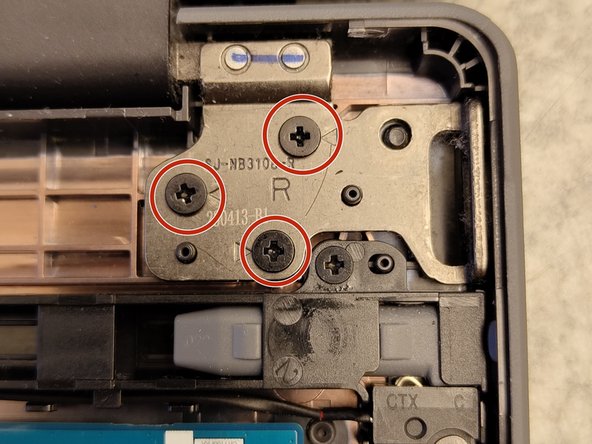

    • Remove the remaining 5 screws (2 on the left side and 3 on the right) holding down the screen assembly to the backplate and motherboard assembly. Marked with debossed triangels in the metal.

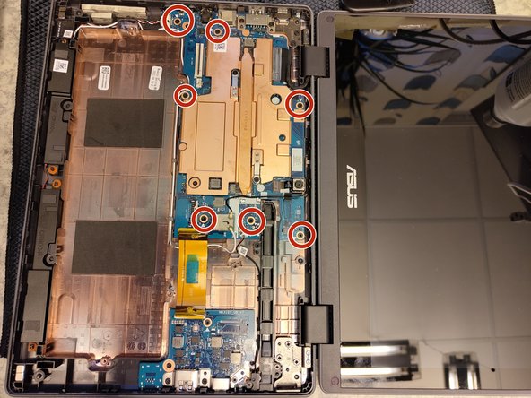

  4. ASUS Chromebook CR1 (CR1100) Teardown, Remove the motherboard: crwdns2935265:05crwdnd2935265:01crwdnd2935265:02crwdne2935265:0 ASUS Chromebook CR1 (CR1100) Teardown, Remove the motherboard: crwdns2935265:05crwdnd2935265:02crwdnd2935265:02crwdne2935265:0
    • Identify and detach all cables. Be observant of the type of connector and cable. Make sure to release latches and only pull on the plastic part of the cable. Some cables require lifting a protective film to access it.
    • The wide Motherboard/IO-cable is especially hard to to lift. Have patience to not rip the cable. Leave the protective film on the connector.
    • The white antenna connector (black was removed in previous step) has a hard plastic cover, lift it slowly from the network-chip cover to not delaminate the metal cover from the chip. Follow the cables through the guided fits.
    • The camera connector has the latch on the opposite side of the cable.
    • Display cable should have been removed in the previous step.
    • Last two cables are the speaker cable at the top and pencil power cable. Pull on the white hard plastic part of the cable.
    • Remove the 7 screws marked with a white triangle next to them.
    • Remove the motherboard.
