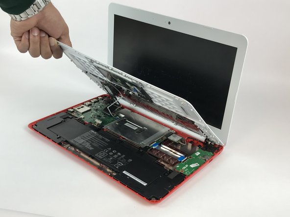

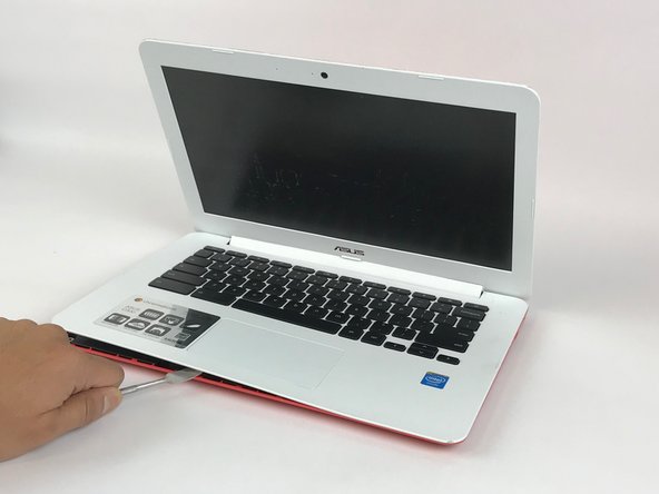

    • Gently wedge the spudger in between the bottom of the device and the keyboard, and carefully pry the cover open. Then, carefully lift up on keyboard.
  4. ASUS Chromebook C300MA-DH01 Motherboard Replacement: crwdns2935265:04crwdnd2935265:01crwdnd2935265:03crwdne2935265:0 ASUS Chromebook C300MA-DH01 Motherboard Replacement: crwdns2935265:04crwdnd2935265:02crwdnd2935265:03crwdne2935265:0 ASUS Chromebook C300MA-DH01 Motherboard Replacement: crwdns2935265:04crwdnd2935265:03crwdnd2935265:03crwdne2935265:0
    • Gently detach connecting cables.
    • Carefully flip up the large black tab.
    • Carefully flip up the small white tab.
    • Remove its corresponding black cable.
    • Remove its corresponding white cable.
    • The keyboard will be fully detached at this point. Set it aside for now.

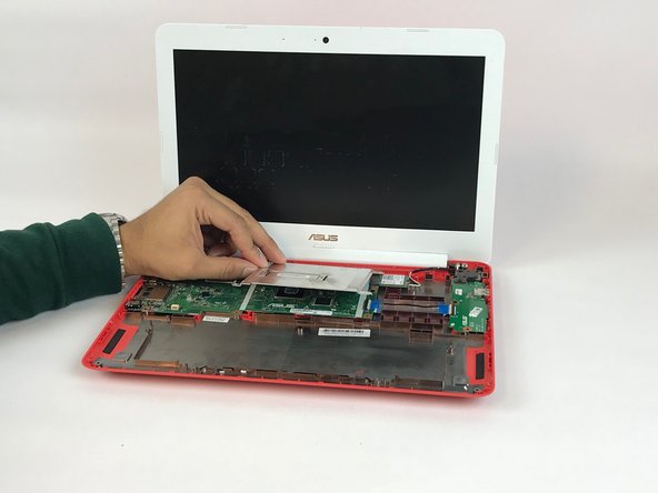

  8. ASUS Chromebook C300MA-DH01 Motherboard Replacement: crwdns2935265:08crwdnd2935265:01crwdnd2935265:01crwdne2935265:0
    • Remove the LCD cable from the motherboard.
    • Peel back the tape and then gently pull back on the connector cable.

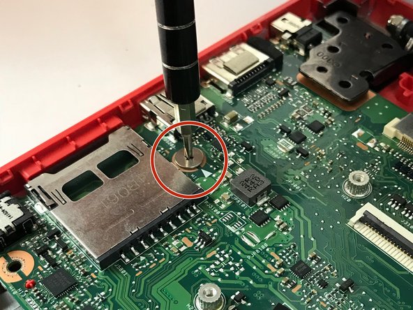

  9. ASUS Chromebook C300MA-DH01 Motherboard Replacement: crwdns2935265:09crwdnd2935265:01crwdnd2935265:01crwdne2935265:0
    • Using the JIS J0 screwdriver, unscrew the 3mm screw.
    • Remove the Wi-Fi card from the motherboard.
