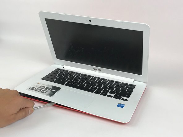

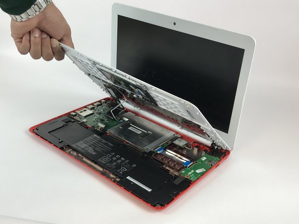

    • Gently wedge the spudger in between the bottom of the device and the keyboard, and carefully pry the cover open. Then, carefully lift up on keyboard.
  4. ASUS Chromebook C300MA-DH01 Keyboard & Trackpad Assembly Replacement: crwdns2935265:04crwdnd2935265:01crwdnd2935265:03crwdne2935265:0 ASUS Chromebook C300MA-DH01 Keyboard & Trackpad Assembly Replacement: crwdns2935265:04crwdnd2935265:02crwdnd2935265:03crwdne2935265:0 ASUS Chromebook C300MA-DH01 Keyboard & Trackpad Assembly Replacement: crwdns2935265:04crwdnd2935265:03crwdnd2935265:03crwdne2935265:0
    • Gently detach connecting cables.
    • Carefully flip up the large black tab.
    • Carefully flip up small white tab.
    • Remove the corresponding black cable.
    • Remove the corresponding white cable.
    • The keyboard will be fully detached at this point.
