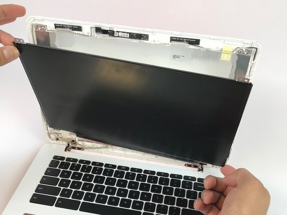

    • Flip open the Chromebook as shown. Using the plastic opening tool, gently pry open the hinge cover of the display. Once it snaps off, remove the hinge cover.
  2. ASUS Chromebook C300MA-DH01 Display Replacement: crwdns2935265:02crwdnd2935265:01crwdnd2935265:01crwdne2935265:0
    • Continue to use the plastic spudger to gently pry the front frame from the display. It will come off with a snap.
  3. ASUS Chromebook C300MA-DH01 Display Replacement: crwdns2935265:03crwdnd2935265:01crwdnd2935265:02crwdne2935265:0 ASUS Chromebook C300MA-DH01 Display Replacement: crwdns2935265:03crwdnd2935265:02crwdnd2935265:02crwdne2935265:0
    • Using the JIS J000 Screwdriver, unscrew and remove the (4) four 3mm screws from the display.
  4. ASUS Chromebook C300MA-DH01 Display Replacement: crwdns2935265:04crwdnd2935265:01crwdnd2935265:01crwdne2935265:0
    • Gently peel back the tape to remove the display.
