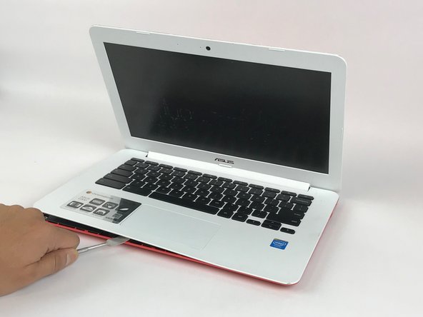

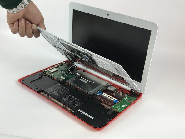

    • Gently wedge the spudger in between the bottom of the device and the keyboard, and carefully pry the cover open. Then, carefully lift up on keyboard.
  4. ASUS Chromebook C300MA-DH01 Battery  Replacement: crwdns2935265:04crwdnd2935265:01crwdnd2935265:03crwdne2935265:0 ASUS Chromebook C300MA-DH01 Battery  Replacement: crwdns2935265:04crwdnd2935265:02crwdnd2935265:03crwdne2935265:0 ASUS Chromebook C300MA-DH01 Battery  Replacement: crwdns2935265:04crwdnd2935265:03crwdnd2935265:03crwdne2935265:0
    • Gently detach connecting cables:
    • Carefully flip up the large black tab.
    • Carefully flip up small white tab.
    • Remove the corresponding black cable.
    • Remove the corresponding white cable.
    • The keyboard will be fully detached at this point.

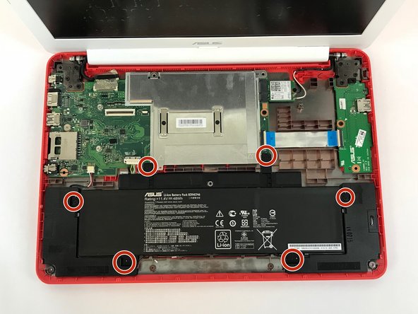

  5. ASUS Chromebook C300MA-DH01 Battery  Replacement: crwdns2935265:05crwdnd2935265:01crwdnd2935265:02crwdne2935265:0 ASUS Chromebook C300MA-DH01 Battery  Replacement: crwdns2935265:05crwdnd2935265:02crwdnd2935265:02crwdne2935265:0
    • Using the JIS-J0 Screwdriver, remove the (6) six 6 mm screws from the battery.
  6. ASUS Chromebook C300MA-DH01 Battery  Replacement: crwdns2935265:06crwdnd2935265:01crwdnd2935265:01crwdne2935265:0
    • Using the plastic opening tool, gently push the connector tab away from the battery to detach the cable.
    • The battery will be fully detached at this point. Carefully lift it out of the device.
